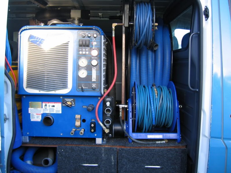

How much room is between the vac hose reel and the TM?
What temps will I get with a 10 flow wand with 70º day time highs?
Can you post a photo of the #5MR blower sitting next to a 45 blower?
Can you have one of these units there to play with on May 30th?

Ive had a couple phone calls and did some emailing back and fourth with larry lately as Im in the market for a new tm. Based on how he explains it , he says that they also route the blwer exhaust through the hx which keeps the hx from getting much hotter than about 230. I dont really understand it but thats what he says. I dont know if there is some sort of emergency bleeding system, If I get one I would probly pay to have put on and set it to around 270 just in case a tech decided to answer a phone call and sat the wand down on full throttle. I gotta say a big reason I have looked at this tm is the waste and fresh set up looks realy space saving
114,149
yep, it's very appealing with the space savings, open construction, easy to get to HX and 56 blower.
I'm curious if the option to forgo to fresh tank and go all waste is available.

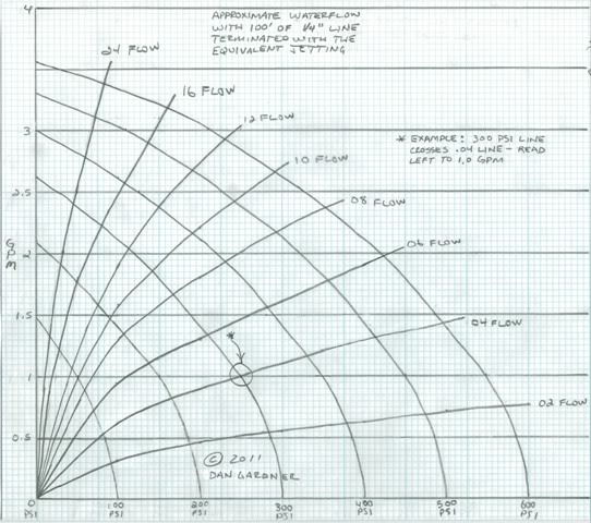

Quick math
10 flow at 500psi=3.5 gpm
50%. Duty
1.75 gal per min
Cobb. 235 at 2 gpm 50 duty
= 235 at 1 gpm
Assume 60 degree start
235-60= 175 rise at 1 gpm
=100 degree rise at 1.75 gpm
=60 degree water plus 100 rise = 160
Answer, 160 degree, at 10 flow, 500psi, 50% duty
Hydramaster
1.25gpm. At 184
Close to Cobb......230 degree at 1 gpm
As comparison , little giant 2,
90 degree at 1 gpm

Rich, how did you calculate that?
Cause I'm not sure it's correct .
'least it didn't come to close to that when "bucket tested" and water measured .
More like 2 GPM.. "if" i recall right

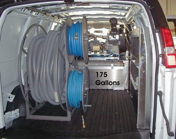

Yes . . .
Some of our restoration contractors opt for the 175 gallon recovery tank.
Larry
