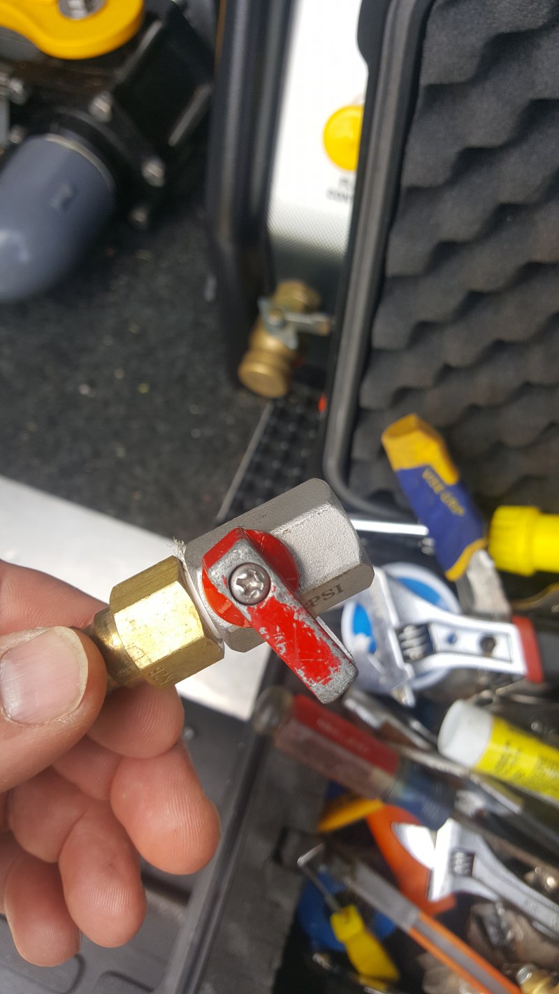

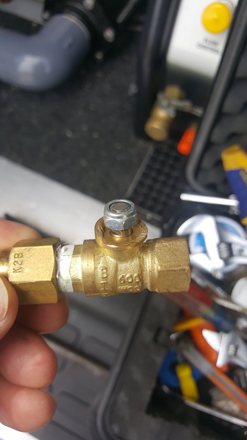

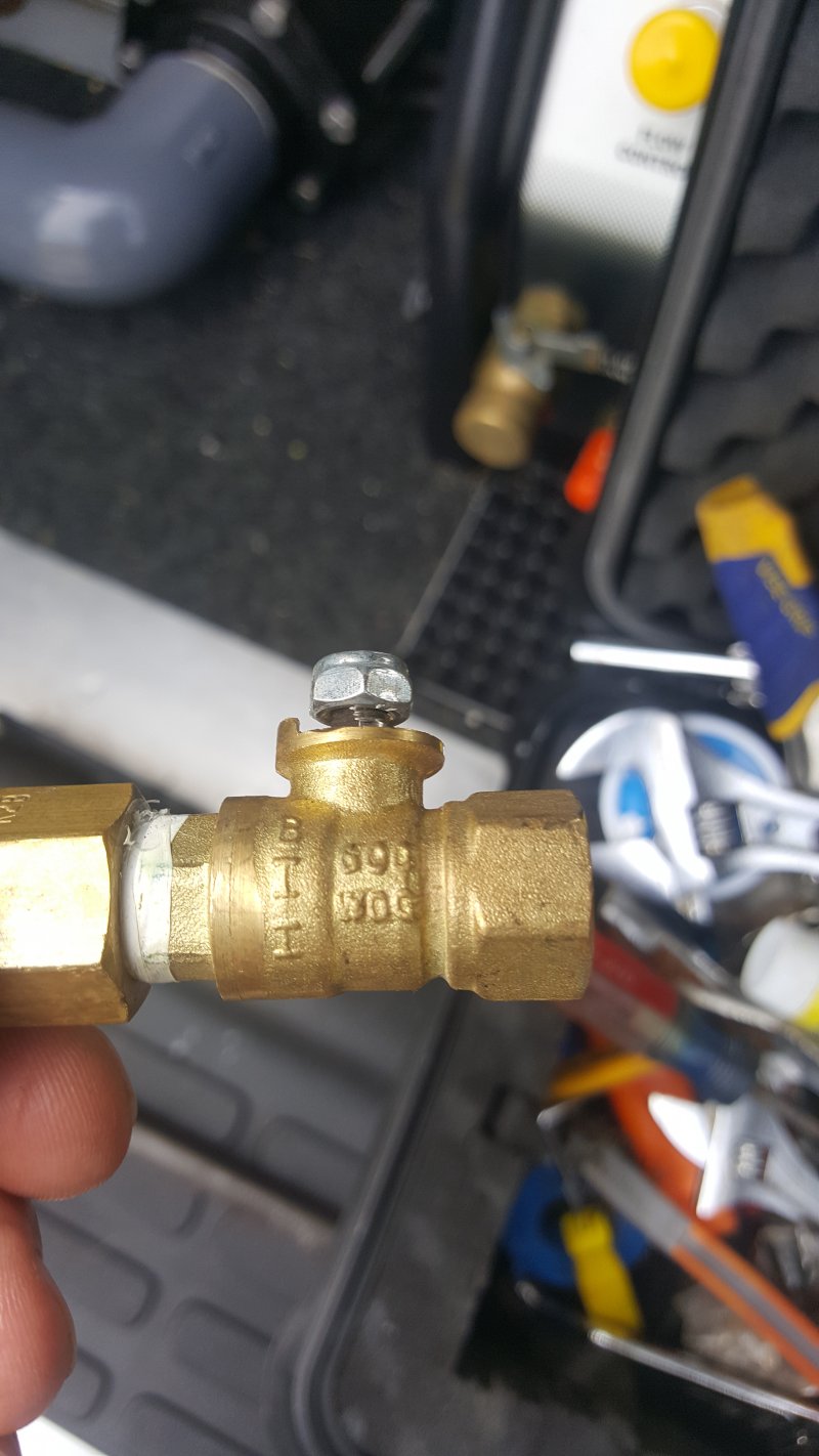

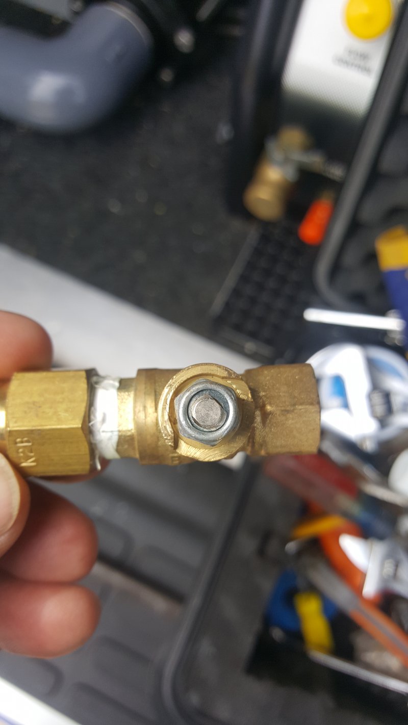

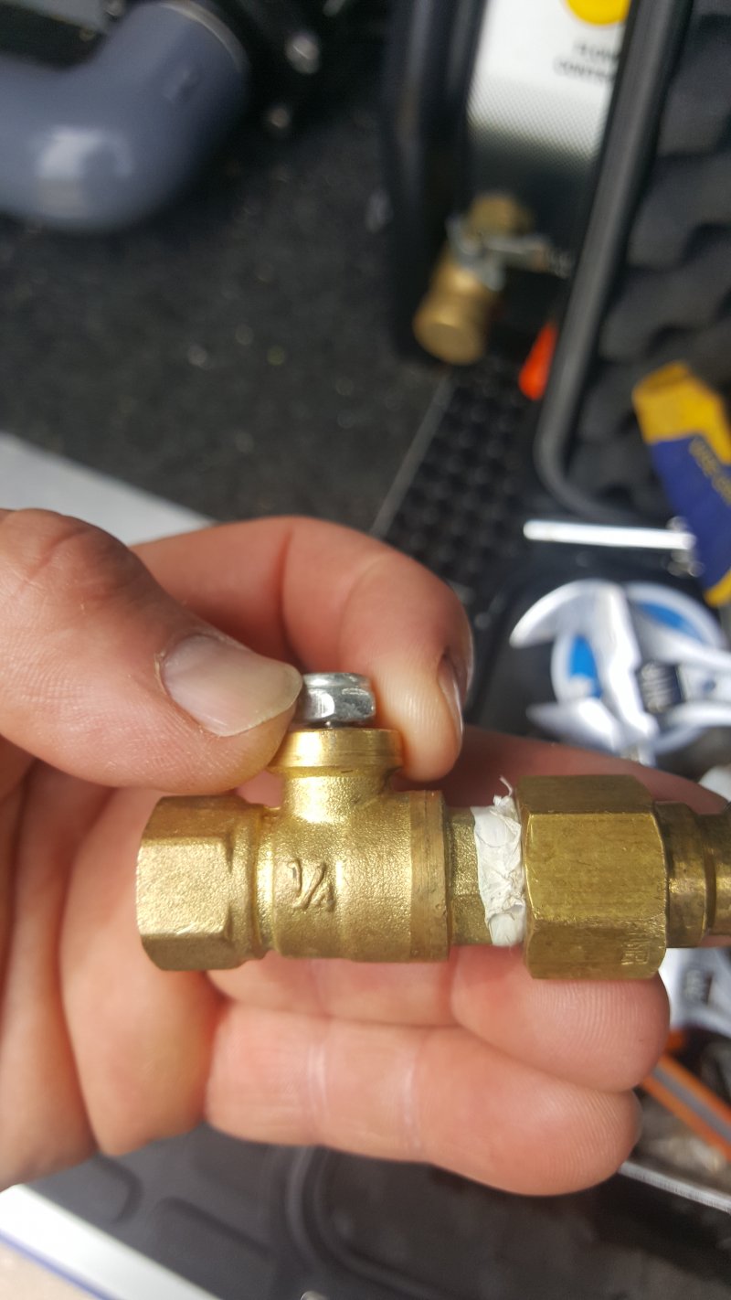

Well I had some time to dig out the valve with the failed handle. It is not branded with Wanders.
I had only bought 2 a few years ago when the BF tough was being spoken so these that I have are possibly different.
My guys used their a couple years ago and I remember them telling me about the handle falling off right away so I guess I never took time to try the one I had until few weeks ago.
Took some pics.
The pics of the red handle unit with 1000 psi on it lasted about a day.
You will have to let me know how yours holds up @Mikey P

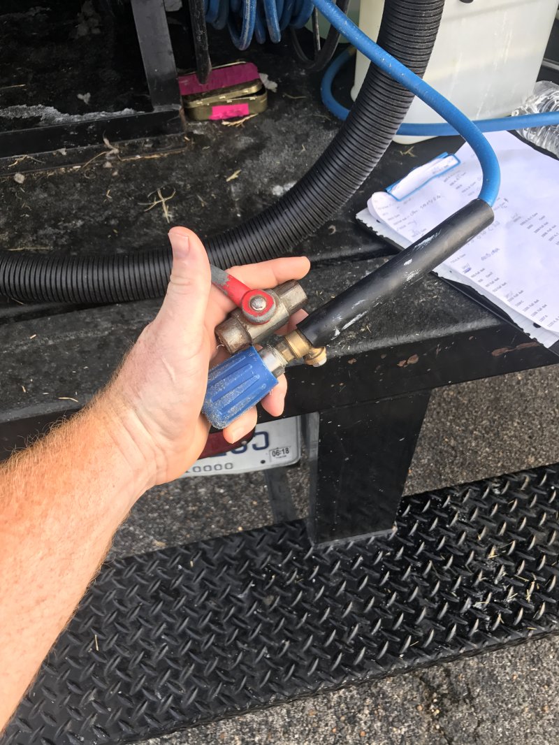

I like the $4 1/4in ball valves from home depot. Made in Italy and they out last any of the industry specific ones I've used.
You can just replace the handle with a smaller one or cut part of it off make it shorter then put the rubber sleeve back on.
So cheap it's easy to keep 4-5 on hand
Reactions: Dolly Llama
I agree .
ball valves have never been an issue for us .
The cheap ones last as long as the hi-priced ones.
Mater of fact, I've had more trouble with these ones by Dwyer than the cheap ones
I'll say though, we rarely ran PSI higher than 600 and never did tile 'n grout
