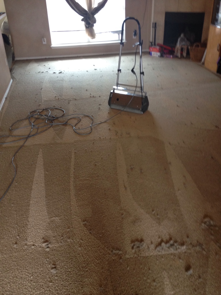

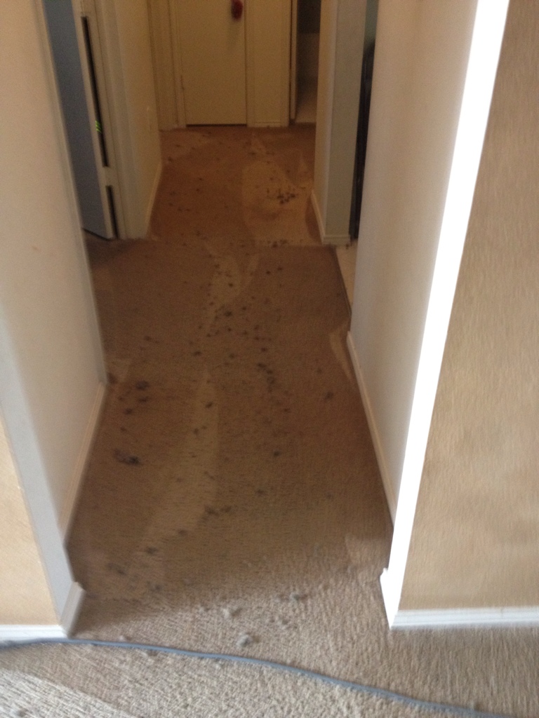

how do you pick up all the fibers and hairs after you use the machine.
do you prespray then run the crb?
do you crb before you prespray?

i know john but the guys complain it takes alot of time and the whittaker/duplex machines dont have trays.
i just want ideas.

they came with the machine i bought, i like them because you can see when they are full. really just looking to see how everyone does it.

While impressive to show all the dust bunnies there are better ways to scrub a carpet and save time.
I use my GLS just for commercial carpets.

That’s just polyester carpet for you. It just sheds a ton of staple fibers. You really notice the difference between poly and nylon with the bagless vacuums. I do try to avoid letting a customer see all the balls of fiber a CRB pulls.

polyester or not, I believe your brushes are too aggresive. They make several brush types for those machines. I use a crb's every day (same type as yours) and don't pull fibers up like that.
