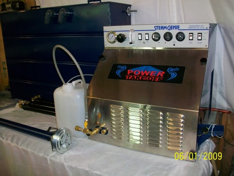

gimmeagig said:
cuff links, I don't know what steam genies are.
THIS...is a Steam Genie

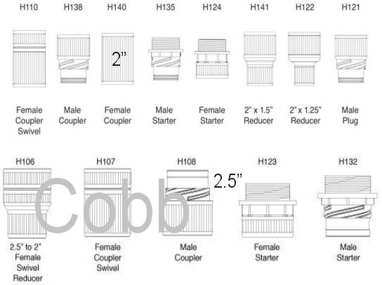

The latest Cuff Lynx have molded in rubber bands for sealing.
They also have 2.5" sizes & 2.5" to 2" reducing cuffs now.
The best part is . . .
they are priced close to the cost of vinyl cuffs and connecting barbs (and shorter in length).
