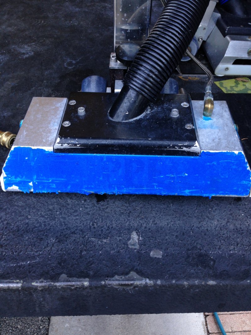

Plastic dip. I spray lots of my tools just to protect customers walls. Don't see why it wouldn't work on the cuffs. I even have a strip across the front of the zipper

Plastic dip is available at Lowes and other home improvement stores by the spray paint. It comes in pint can for actually dipping tool handles in or a spray can.

Here's a slightly worn zipper with plastic dip on front. It prevents the little marks on the walls that I can't keep my tech from making. It comes in cool colors and just peels right off if you don't like it. I'll add a couple more coats and this will look like new again.
