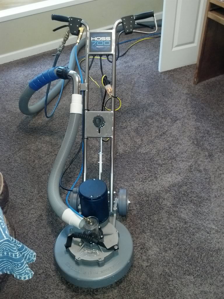

Took me about an hour to put it together
Lurch kit
Wiring

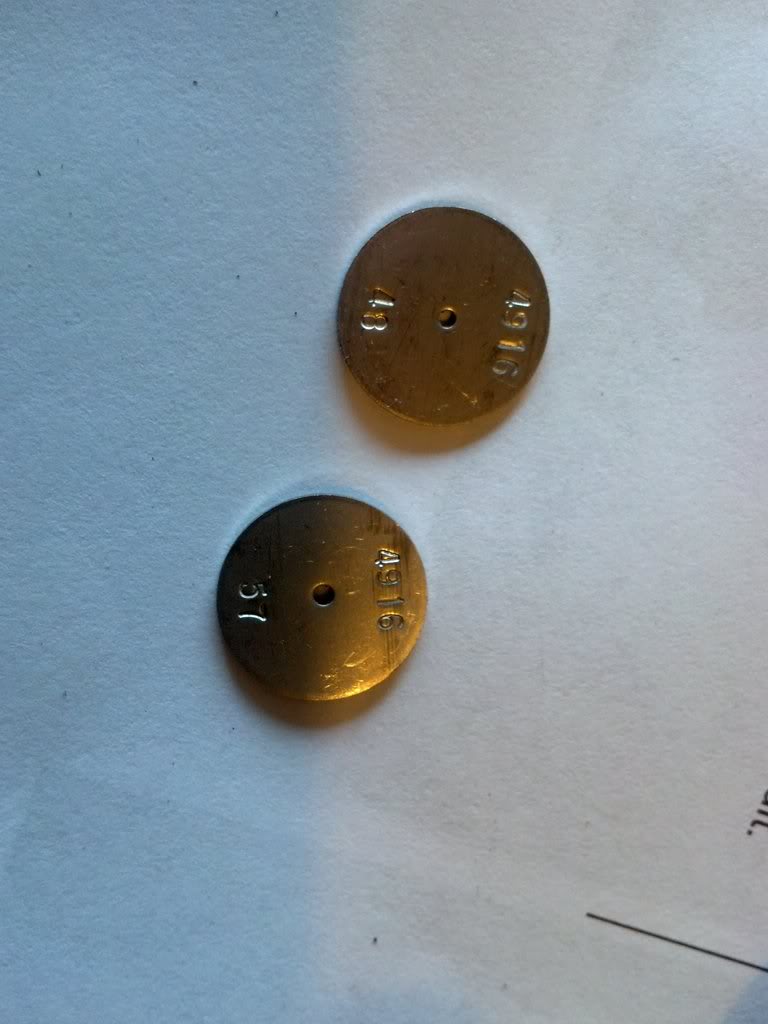

Flow disc
a few other nuts and bolts, some of which I had to supply because someone forgot to put them in the box.
When I first hit the power I was immediately aware of how much more power/ torque the Hoss has compared to the 360i. @ 145 RPMs/1/2 horse it really feels like a 175 type/1 horse swing machine.

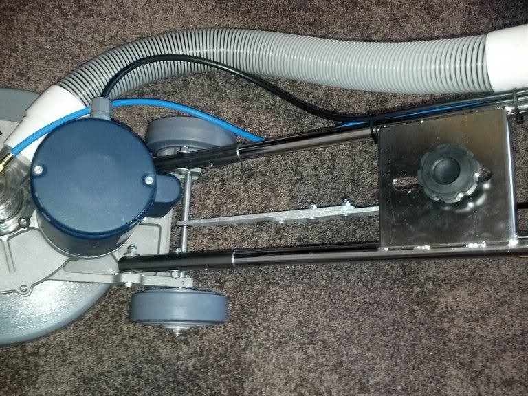

You can see the 8 inch or so extenders on the handle where they meet the base.
The unit come with three different "Flow Disks" I tried the middle disk first on my own carpet but ended up with the least amount of flow disk by the time I was done with two rooms.
This things puts out a lot of water with the new jet system
I had an issue with excessive vibrational noise but a call to Studebaker got me working on tightening up one of the wheels to shut her up. I had to add an extra washer behind the wheel and that did a lot but there is still room for improvement in noise reduction with some closer tolerances in the axle system.

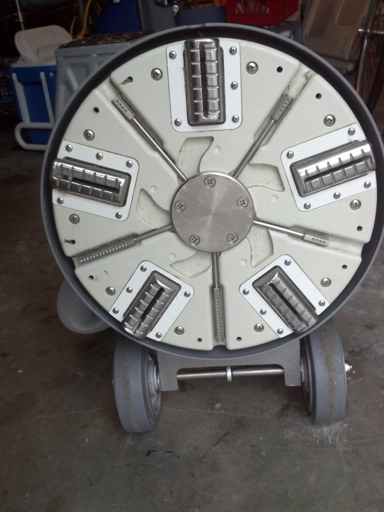

Any issues with jets clogging yet?
Do they still have varying placed pressure jets so that each cleans a portion of the width of the vac shoe? That's the thing I don't like about the design. Seems all jets should fill out the whole area like other rotary tools for a more consistent rinse.

Any issues with jets clogging yet? Not after 2 rooms
as for jetting those two long bars are like fire hoses.
easy access to clean out all 5 spray bars if needed, unlike the 360i this comes with an inline strainer
Richard Baldwin posted pictures and results of the Hoss with all 5 jets converted to full length instead of just two. That was on the *** board.
He seemed to think it cleaned better/faster configured like that. He said the spray strength was less than the standard version because of the difference using the 5 full lenght bars.
Perhaps with the lowest flow setting, using 5 full length spary bars would not overwet while cleaning faster, making dry times reasonable.

I think it could use some glides for better water recovery and less torque on the motor, but it doesn't look like glides could be added to the stock shoes with all those slits in the shoes for better air movement of the stock unit.

no need for glides on this....because of the little slots that are cut in the vacuum shoes this machine has some of the best recovery of any rotary out there....
2 long and 3 short give you the best of both worlds...you get both flow and penetration....

I think the recovery is better on the Hoss . . .
due to the vac head design with the lower trailing edge to squeegee the water out of the carpet.
