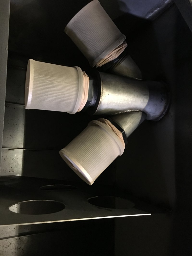

are you Dev users using panty hose on your tank filters?
I've tried, hoping for the best. The Cleanco filters are very fine. It doesn't stop me from having to pull them out and rinse them off.
I really wish it did.

View attachment 11252 I put new pantyhose on my blower filters every 100 hours as a precaution. I also run panty hose in my devastator and throw them out after about 2 jobs
Over the blower filter is a great idea and one I'll be employing from here on out. I find that the pantyhose clogs very fast though in the waste water filter. That's one reason I disliked the Mytee filter design.
