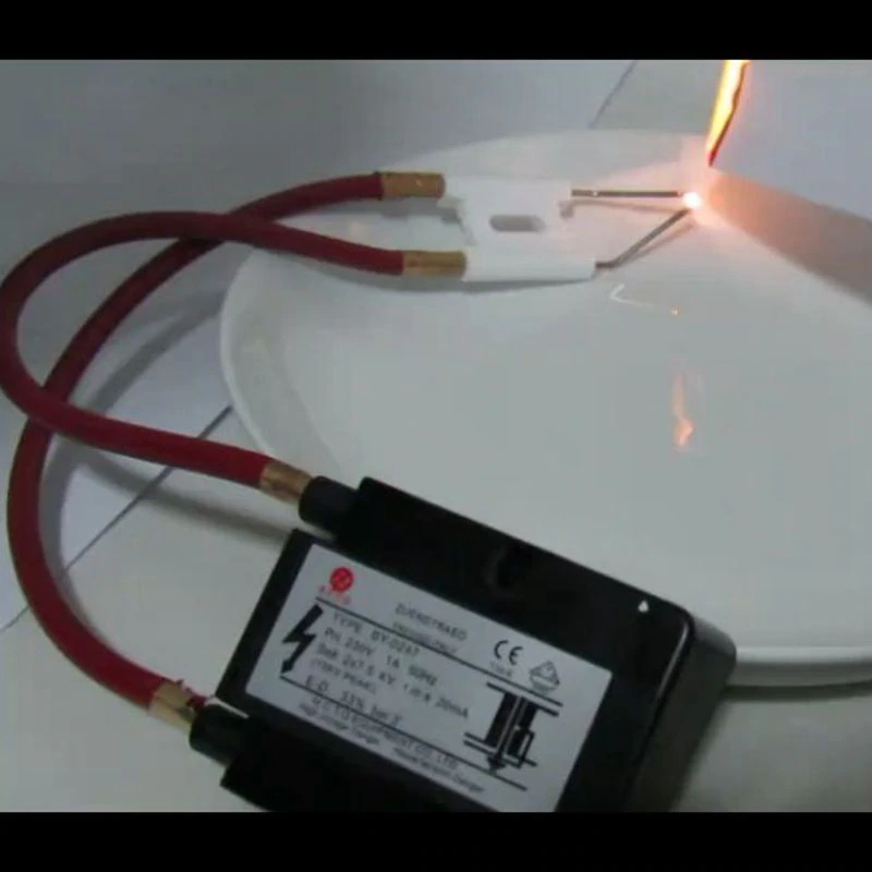

Atomized fuel blown across ingniters (the "pilot light" of fuel fired systems)
Only it's not a flame, but continuous arc spark

here's a look at a typical igniter
