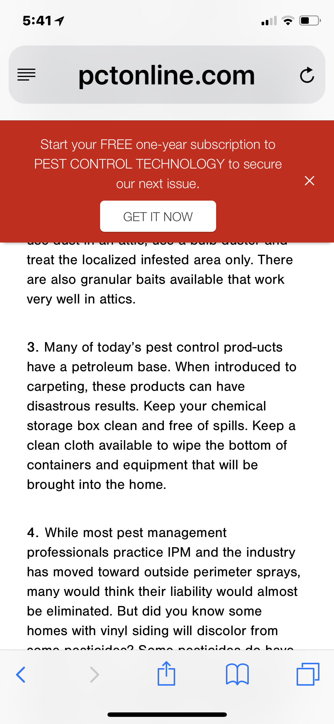

Bug spray?
not a bug spray guy..butt
be an odd place to apply bug spray, wouldn't it?
middle of doorway and middle of transition strip??

Look again that’s a closet imagine it closed and spray boy getting loose!
And edges are are where they spray!
Ps it’s nothing Tom used!
Could be a swamp cooler with chlorine in the water but I doubt it!

Bug spray normally puts off an orange color, but that could be. Ask her if they cleaned the walls with any bleach in the past. It's hard to believe that the rundown from the wall would go out 2-4inches, but you never know.;

the one I saw with the bleach she had sprayed it on the walls with a trigger sprayer so the misted overspray was approx 4" out from the walls
