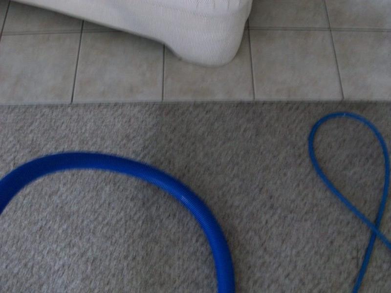

I always spec a thorough vacuuming or add a "housekeeping" charge at the customers option.Again, I didn't move any furniture other than the sofa and dining chairs, so maybe 500 sf of open area. Ultrachem Clean prespray is the best all around product I've ever used - it'll even move rust.Move it, not hide it. I go there to work, not chat up the customer. I try not to waste motion- period, once I start, I just bust ass until it's done. I'm not paid by the hour so if I'm able to get the job done to THE CUSTOMER'S COMPLETE SATISFACTION in as timely a matter as possible, good for me. If a stain doesn't come with the 3 spotters I use, a solvent, a general spotter (Clean in a stronger solution) and a peroxide, than I add to the bill for work over and above the cleaning charge. I don't sweat the petty things and I don't pet the sweaty things.

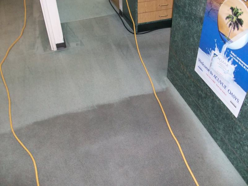

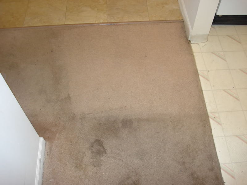

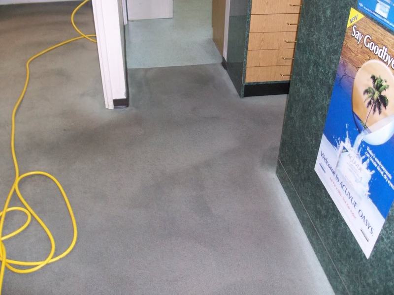

How are these results? (Just tap hot water on this one, a greasy trail from the kitchen to the bakery at an old folks home.)
Just playing in a doorway to see what to expect.
A dirty olefin?
Commercial nylon?
