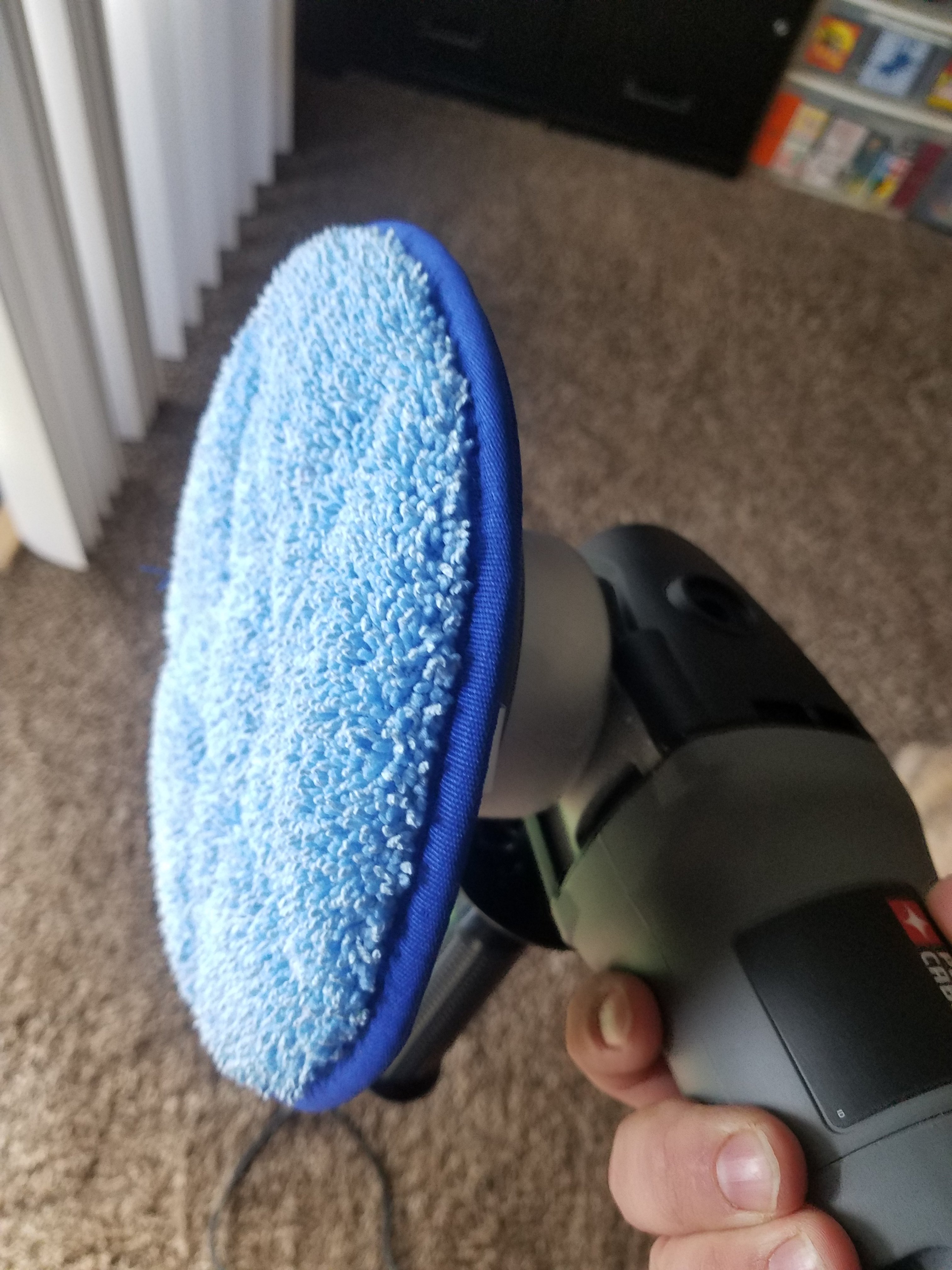

George
Yes I do. I use a 13'' light blue microfiber bonnet by hand after cleaning upholstery to help absorb some moisture and to help with drying.

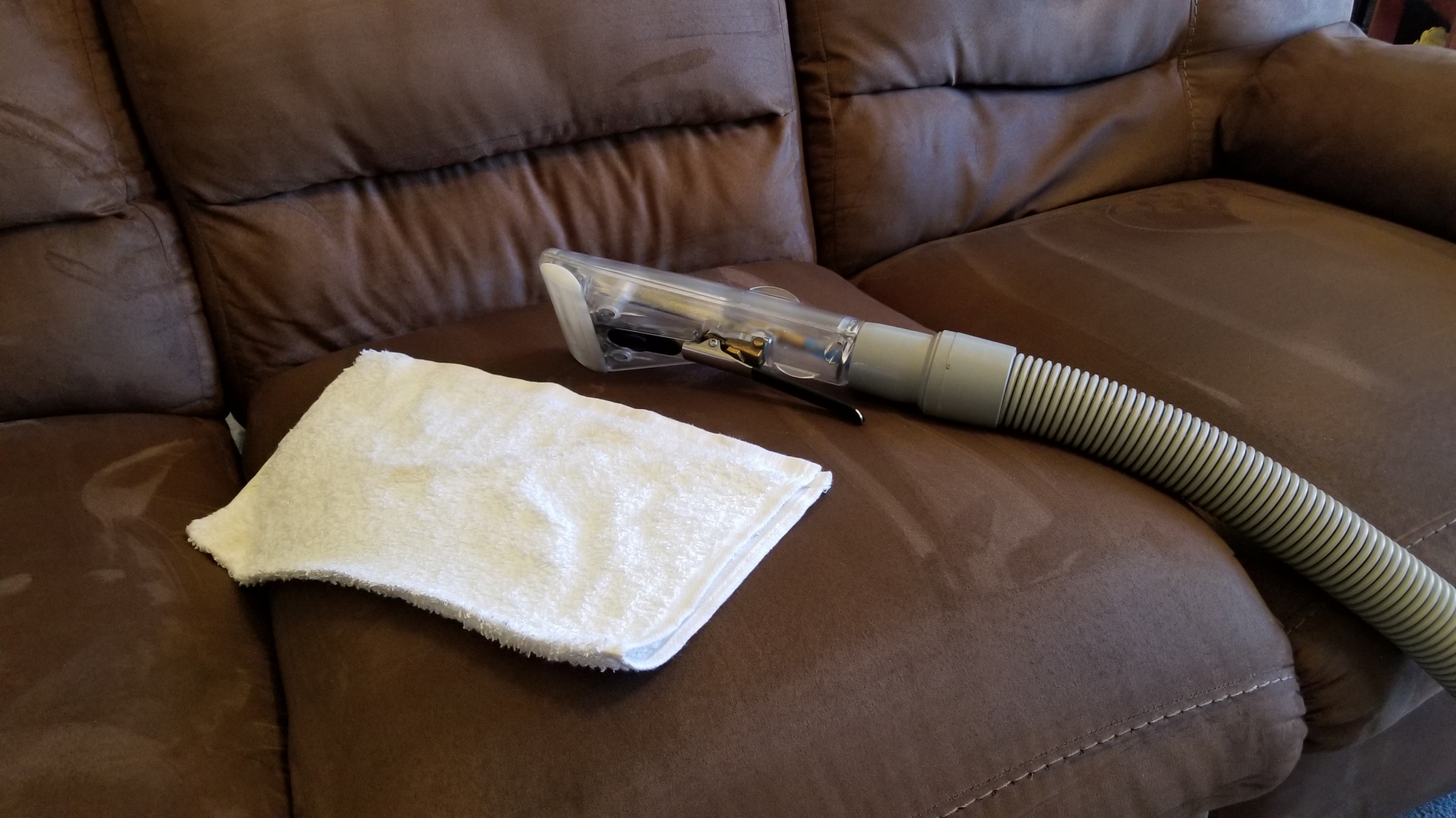

I did a sofa the other day which had a tidy sawtooth left by the last guy. I think he used too much heat, because it would not brush out.
So I vacuumed, sprayed, scrubbed with a soft brush and washed the sofa with warm water, then toweled it off (section by section). It worked; the sofa looks like spun gold, with no tool patterns. Very gratifying, especially when the owner walked up behind me and observed “The other guy didn’t do ANY of this stuff! Looks great!”
