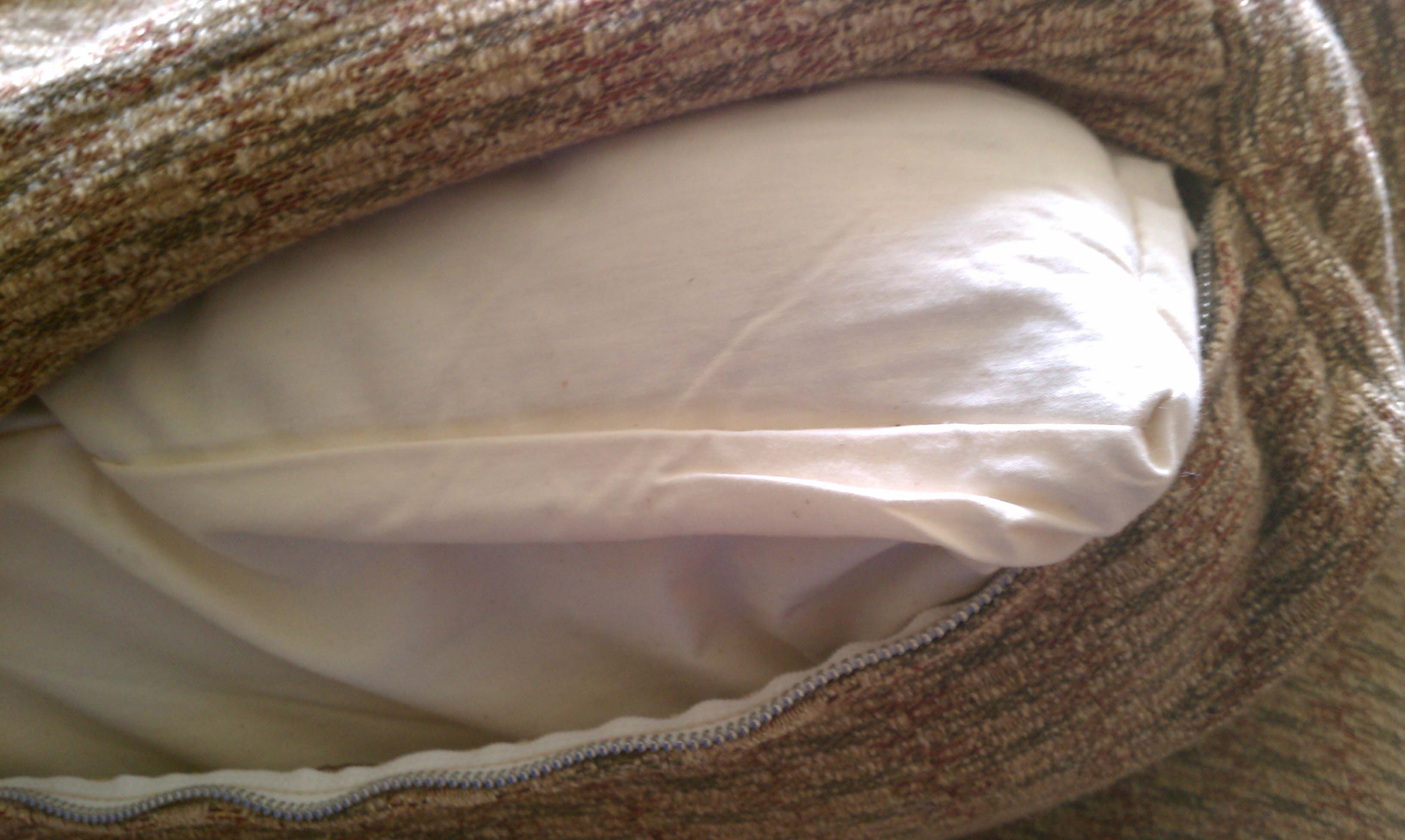

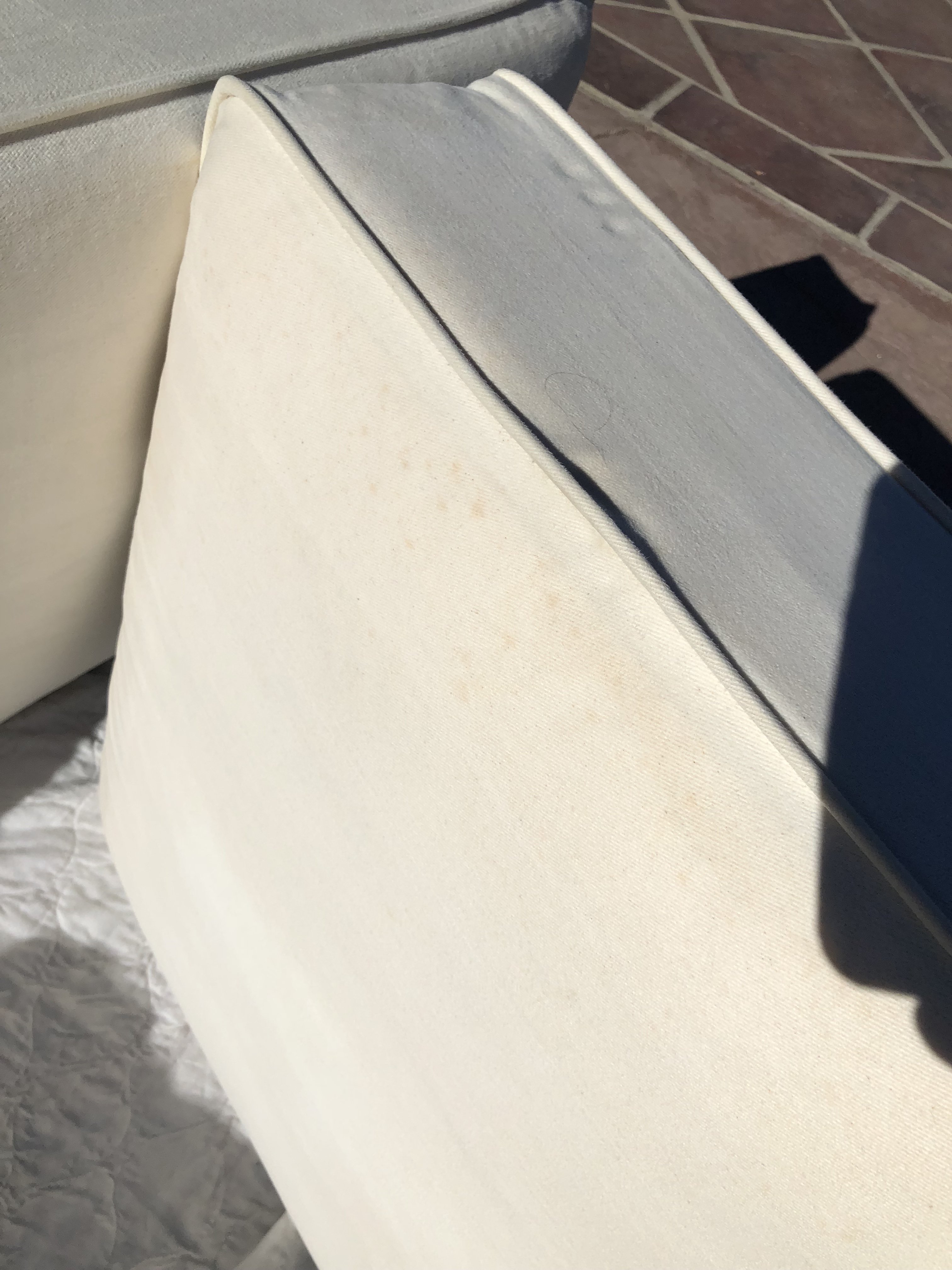

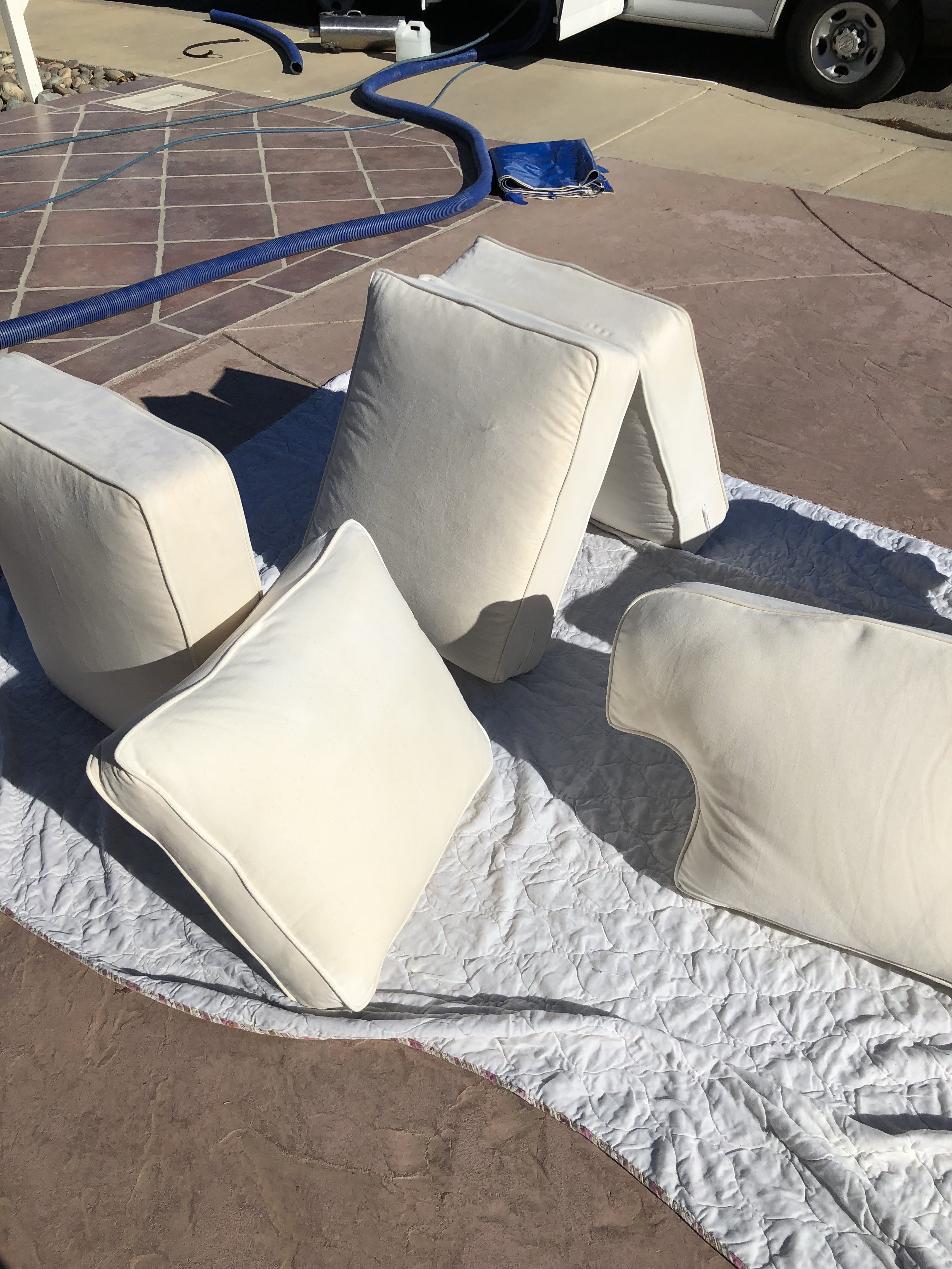

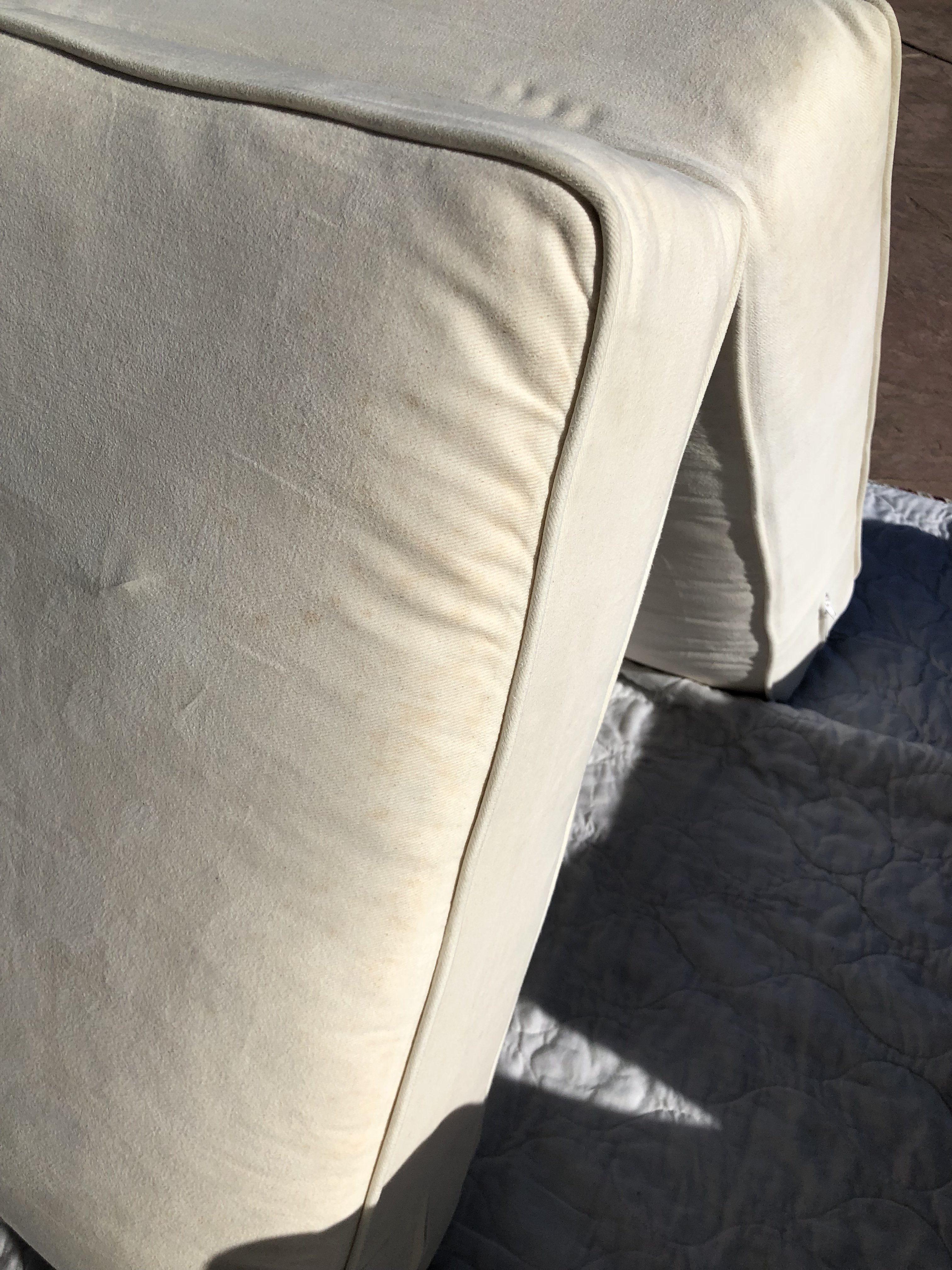

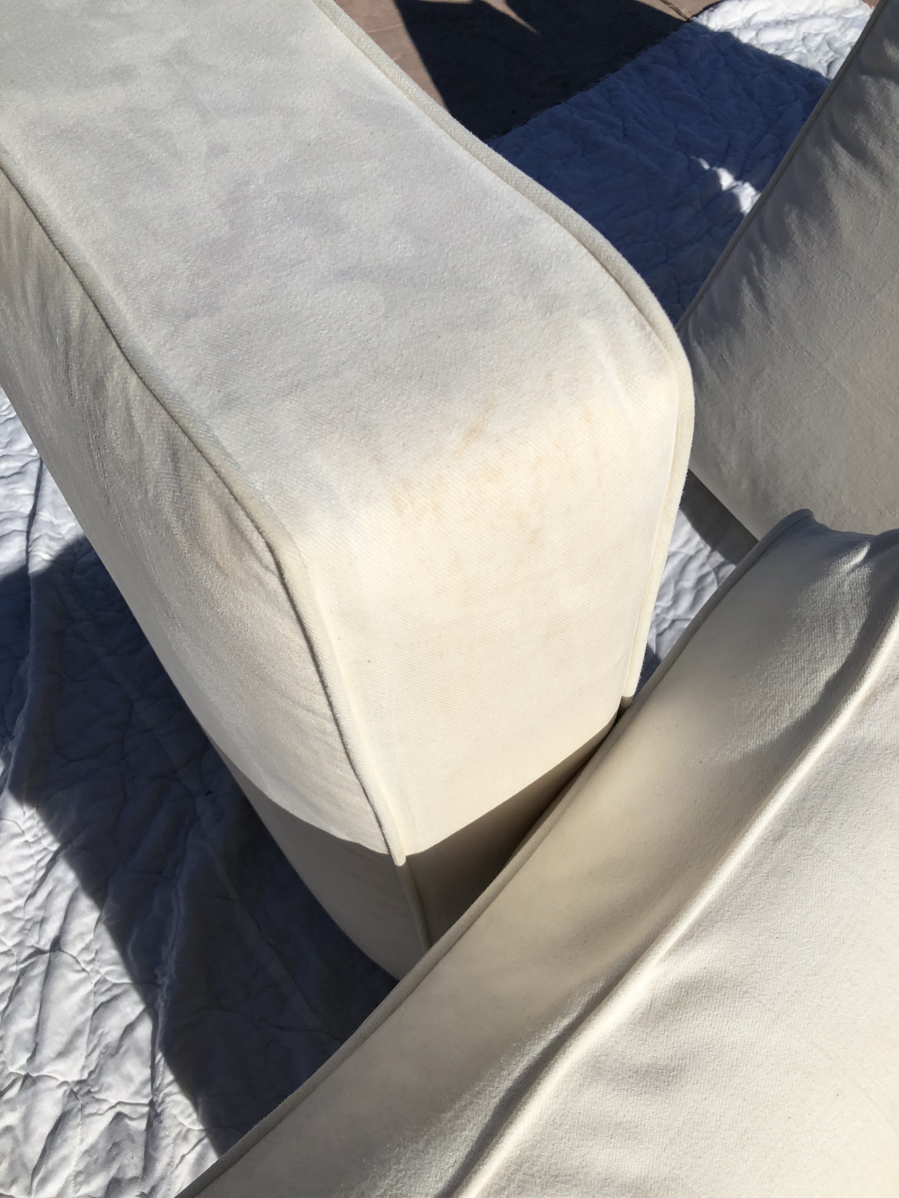

I cleaned these years ago, they’re moving out of the area and the lady said she started noticing these spots, she said she thinks she caused them by spraying something to close to the couch.
When I pre sprayed it the popped up on the seat cushions only all around the edges.
They were lighting up a lot during drying.
There’s white cotton bag filled with foam.
Almost looks limes it’s coming from the bag.

Even though there aren't feathers in the cushions, sometimes you can run into flame retardant on the ticking.
Do a pH test on the ticking (inside cloth "bag") and let me know what the pH reads.
Cleaning Professional
117,387

how do you pH test a fabric like that?
You don't test the fabric, you test the ticking, if its accessible.
I rarely see this on fabrics that aren't down filled, but I've seen it enough to make me suspicious that its contributed to the problem. @Bryan Ohaleck has seen more than anyone I know, maybe he can chime in?
12,856
Either will work. A reading under 6 is suspicious, under 5 is nearly a guarantee of a problem.
I can't tell from the pics what it might be. Dyed fabrics turn pink to red; white fabrics turn yellow to brown.
