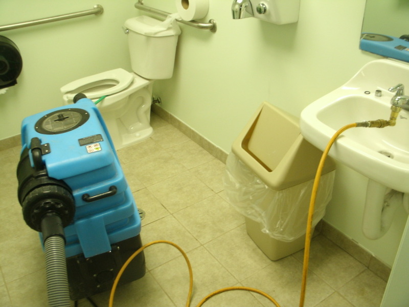

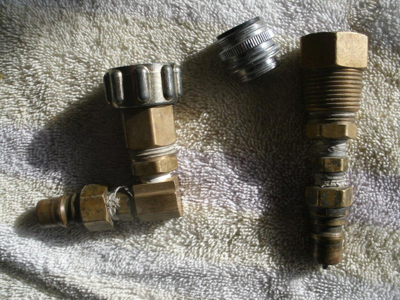

Last week I was doing a job and yet again my garden hose was short by 15 feet. After countless times of this I decided to do something about it. Since I carry 2 lengths of 50 foot solution hose in the truck that are extra I have decided to be able to utilize them for these circumstances. Here is a picture of what I made and I hope it helps somebody else out too.

good idea, Dan
you know, those could also be used if pump/belt failure to finish a job by hooking direct from facet to wand .
with faucet adapter, you could also get some hot tap water to the wand

very true.

My box truck had a live water hose reel. My butler does not and I only carry a 50 foot hose. Now I will be able to reach 150 feet if needed.

Heck, if you're blower/belt also failed you could go all the way with this and finish up fine:
I have a few of these adaptors, the 90 degree bend allows work with shallow sinks:

im not selling them Waldo. I just shared what I did. I got all the cheap brass at Home Depot since I was there helping my mom out. Spent around 15.00 bucks on the brass and I already had the QD's at home. This will be slower filling but in a pinch its gonna work great.

Did you test them yet Dan?
A bit concerned the restricted flow would take eons to fill a empty tank..
Great idea though
It you have a reliable float shut off valve. You can just turn it on at the job and forget it.

It's still faster at lower flow than rolling every thing up and moving the truck hunting for a closer spigot.
exactly. It's not meant to be your fill the truck option. This is more restrictive but when in need it will supply more water in than being used at one time. Way faster than breaking down and having to move the truck.

Not exactly. What I was saying is a carry a 50 footer garden hose and came up 15 foot short. Keep in mind my butler has a fresh water tank. Every now and then I lose track of the amount of water I have and when I'm cleaning realize I won't finish the job for whatever reason. So essentially this allows me to keep my 50 footer and be able to ad 100 foot of solution line to it if needed. The idea here is NOT to fill your tank but to prevent you from having to break down to get water. This would take forever to fill a tank. It keep you going in a job.

Okay, so I used these today and worked awesome. Had vacuum and pressure lines all set up and ready to go. Pulled 50 foot solution line from back of truck and hooked up. I have a 110 gallon fresh water tank that was completely empty. Water now flowing and truck running I went to work. After about 45 minutes of cleaning I finished with no problems. Fresh tank was now 3/4 full and I only cranked the water on less than half way.
Several of you have posted on adding more garden hose and how to change my ways.... This entire post was about when your garden hose comes up short and you need a fast fix. Not only is this a great way to get more water hose length on the truck it more importantly utilizes supplies already on the truck. All I did was ad the connectors to make it work and the other thing is I also have more brass if needed because I could tear them apart if I needed the couplers.
