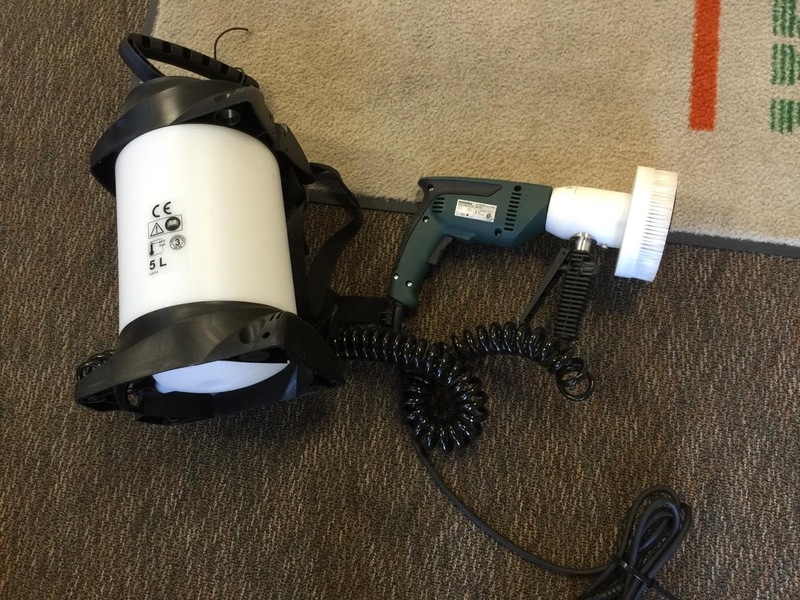

CCA will bring this Foamer unit to both Atlanta and Nashville for us to clean Kellie and Meg's bufonts with..
