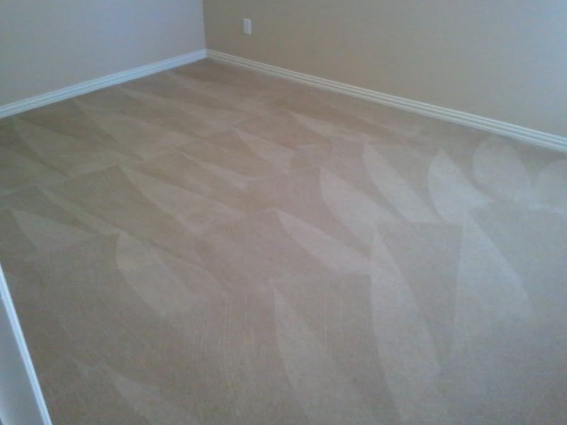

I can see NOT doing a forward stroke without a backsaver.
But I like the patterns too much.
Unless you are going to groom :roll:
Nobody wants to see straight columns after cleaning...I think it looks trashy.
Brian R
Jun 13, 2008
19,945
Little Elm, TX
Brian Robison
This is kinda half assed grooming because it was a rental
But it gives an idea of how to pattern a carpet when cleaned correctly.....It's a groomer, not a wand....So it's not as consistent...Don't hold it against ...I don't have an example of a wanded room.
