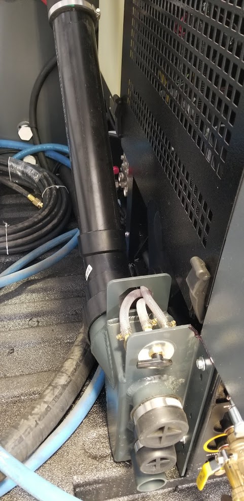

Dual wanding with the Everest
117,297
a 50 of 2.5 to the Dev Filter, split to two 2"s of 50'.
Screaming heat and great suck..
until the other guy lifted the wand....
Next they'll try the 2.5/Dev/2" by itself and use the two 2" ports Y'd to another run of 2's. No filter on the full 2" run.

Where’d it go?
If you look at the pic in Mikes first post, he had a custom intake made for it. Where you see the dual 2”, and single 2.5”, that’s where the drop basket was. His reasoning is, he uses a Dev filter, so there was no point on keeping the stock basket box. THATS WHY.....

14,632
I think that's gonna be a regret after several months. When the devastator gets full in the middle of a big job, he's not gonna have anything to fall back on. With a basket behind the inline filter, he can just disconnect the dev, and get back to work and have the basket in there as backup. Now he'll have to replace the paint filter in the middle of a job
