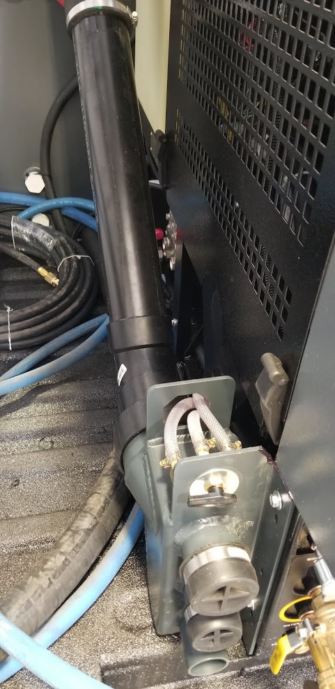

Dual wanding with the Everest
D Luke
Apr 12, 2015
1,033
Derek
Wouldn't think it would make much of a difference but in my experience you gotta split right at the machine.
Honestly your best performance would probably be just running 2 separate 2" lines right off the machine. Either separate or no inline filters.
You could try one 2.5" and one 4td like you said, but I think they would flow so much difderent and create an imbalance between the two.

Never ran anything close to a dual wand machine but surely the air flow goes the line of least resistance?
2x 2.5 from machine to 2x 2" as close to equal lengths of hose as possible?

The saving grace is that the Everest waste tank has a very sloped bottom, designed to actually drain out 100%, if'n were to need to go filter-less. With the dual door design, ti's a piece of cake to rinse it out.
I love the sloped design of the tank. I doubt you would have any problems running filterless after a prevac.

a 50 of 2.5 to the Dev Filter, split to two 2"s of 50'.
Screaming heat and great suck..
until the other guy lifted the wand....
Next they'll try the 2.5/Dev/2" by itself and use the two 2" ports Y'd to another run of 2's. No filter on the full 2" run.
what size is the hose from the blower to the waste tank, waste tank to header?
