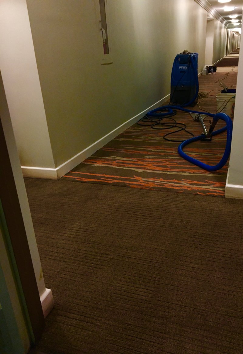

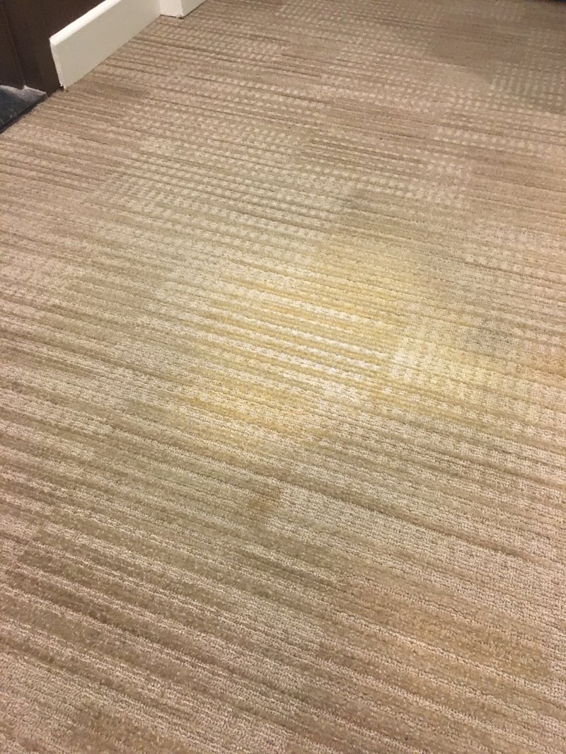

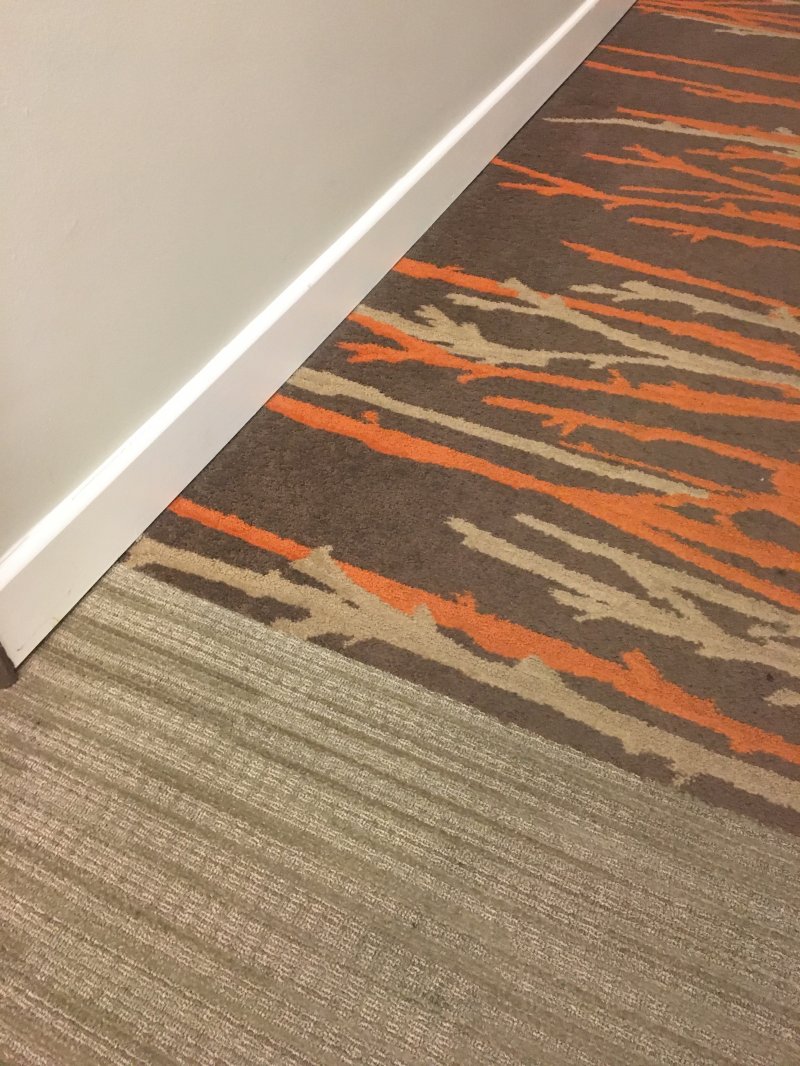

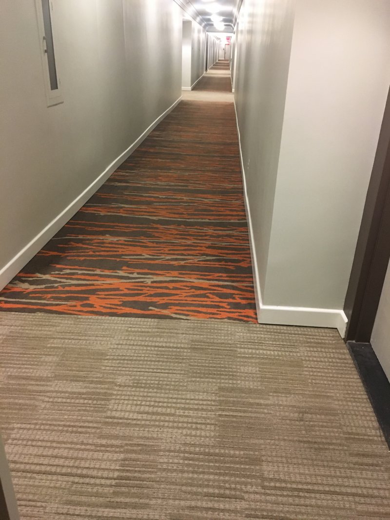

Interesting job that we just got in. High-rise condominium building just outside of Washington, DC. They have 19 floors with dark brown carpet with stripes running through it. These hallways and are almost as long as airport runways! They have beige sections of carpet interspersed throughout the hallways and want them dyed to a dark brown to match the color of the dark brown in the patterned carpet.

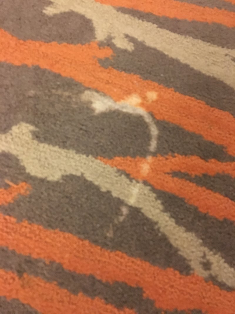

They also have bleach spots throughout the patterned carpet on every floor.

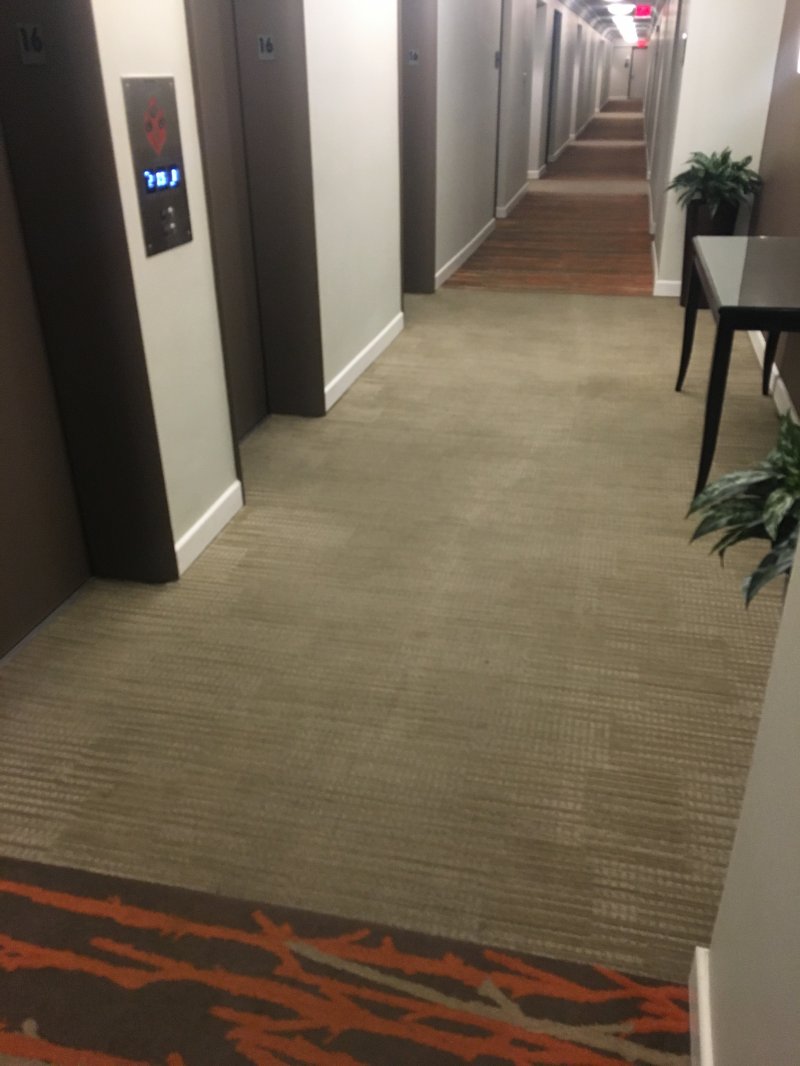

That last one looks as if they already have accent lighting installed.
Would be cheaper to put in a few more to make that one blend in with a pattern.!!! JKing.:biggrin::biggrin:

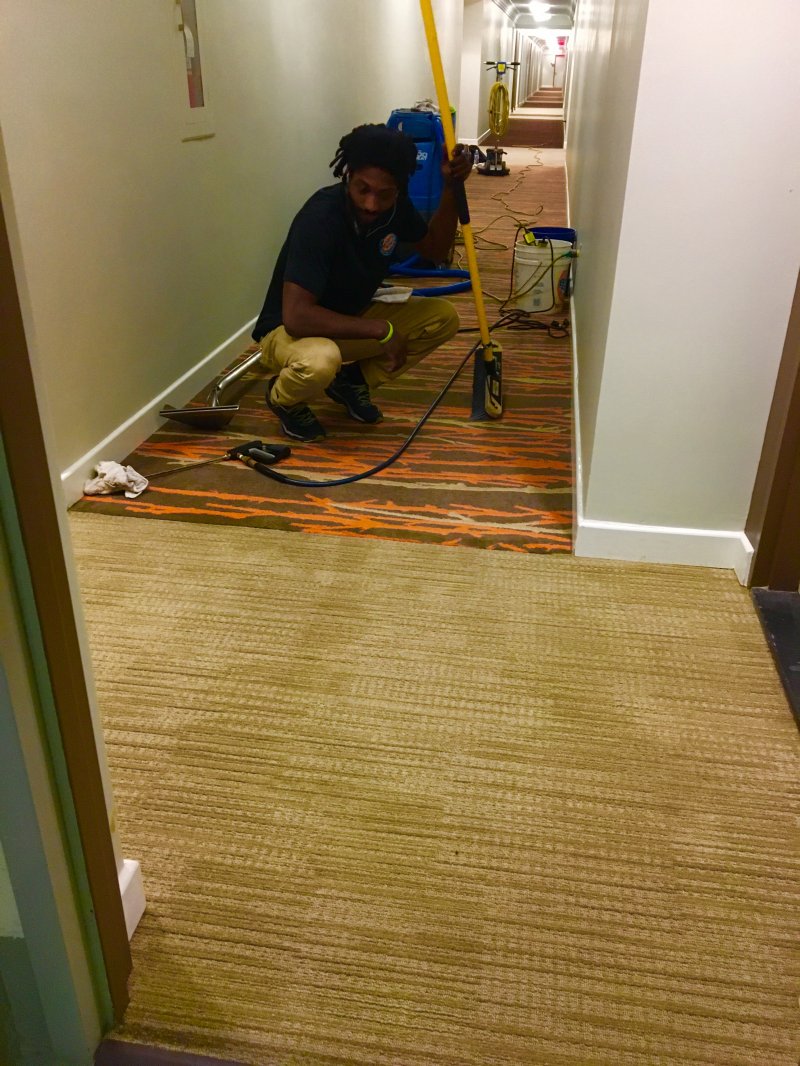

When I used to do whole room dye jobs, I placed dye shields all along the wall to keep from getting dye on the woodwork and walls.

The pic was taken before my technicians had cleaned up the walls. Sometimes we use a dye shield to protect the walls. Most of the time we simply wipe them down with a rag that's been dampened with bleach.
I left my technicians to do the cleanup. Job turned out just fine. Walls were clean when they left.

OK, if that works for you. I would try to protect the walls and base before the job so I wouldn't have resort to bleach in removing dye where it isn't supposed to be, especially if I weren't there to personally do it, or at least to supervise.
