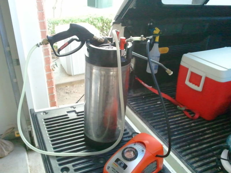

Right now I'm using a keg sprayer and a car tire pump.....Works amazing. I hooked a pressure sprayer gun from Northern Tools and a 3ft hose from it.
Fill it about 3 1/2 gallons and leave 1 1/2 gallons of air......80 to 100 psi and it's good to go.
The Black n Decker air compressor can hook to a cig lighter in the truck or to the AC plug in the home.

Pretty close to the set up we used to use with Chem Dry years ago.
T Brevick has a video somewhere of him using one.
I think the total set up was probably around $125.00
Bought the keg used from Jay D
Got the connectors online for $20 or so
The pumps was $30 I think
The gun was probably $50 :shock: I bought a bunch of tips.
