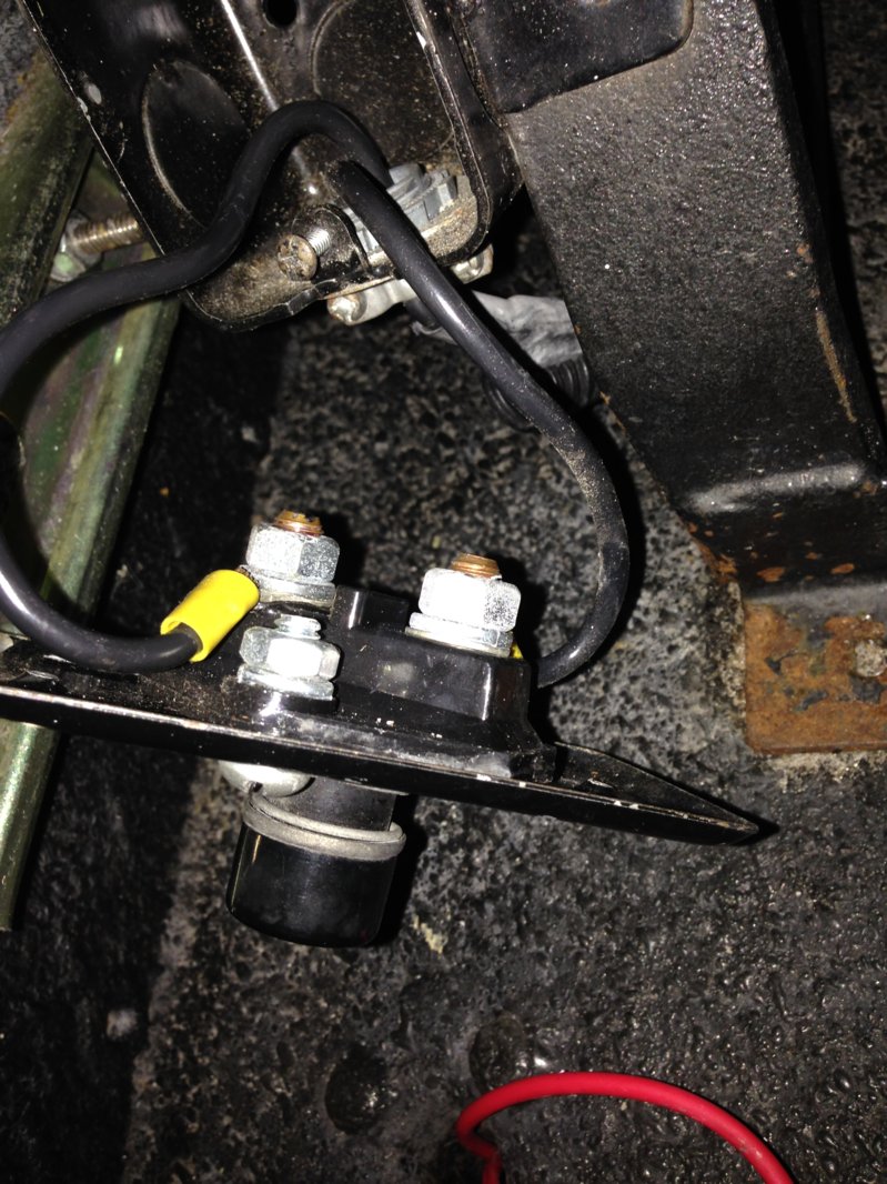

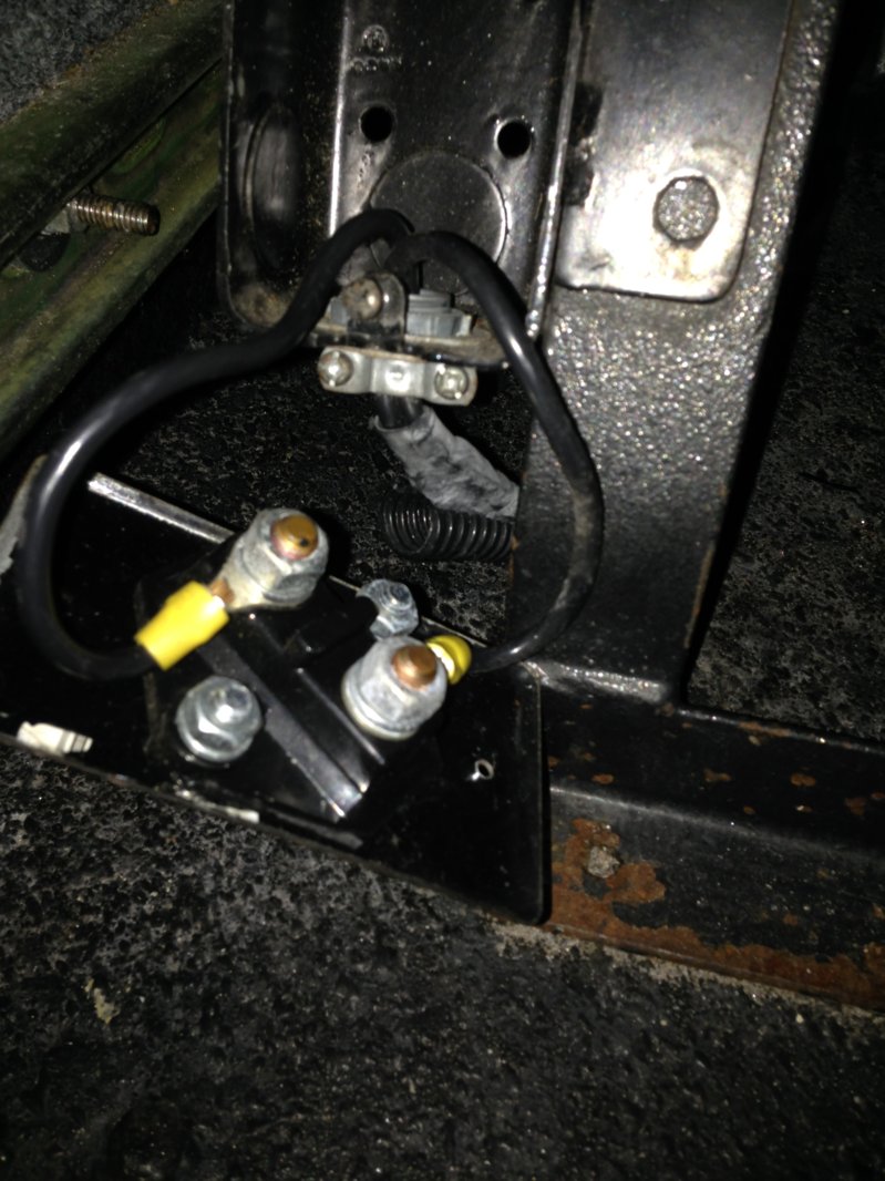

the button that makes it work died today. where can I get a new one. My supplier doesn't carry it. It looks like a part you could get from an auto parts store. It's just a heavy push button like a horn button.
Not on this one. It uses a heavy duty switch so no solenoid is necessary. It's pretty old.The motor starts with a solenoid, about 40 amps output.
Any momentary switch with smaller wires can be used to trigger the solenoid.

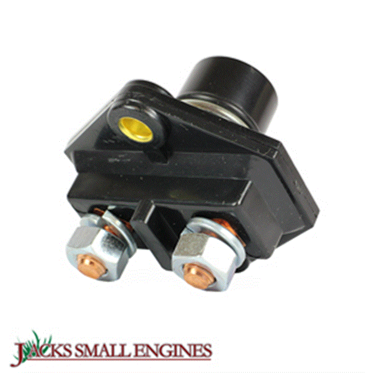

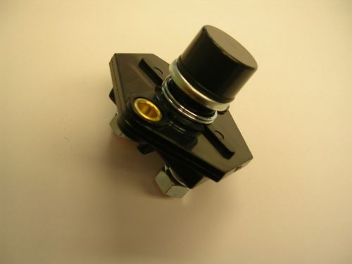

That looks right. Thanks Fred.looks like it could be a generac starter switch
http://www.jackssmallengines.com/jacks-parts-lookup/part/generac/77282gs
ordered. jerry rigged until then thanks Fred.if it is there are several on ebay for $30ish
