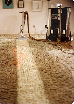

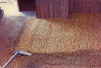

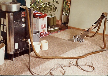

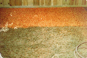

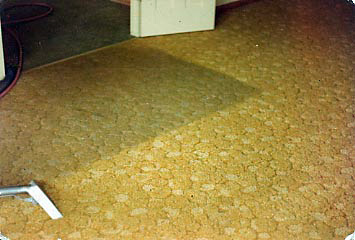

These are some pictures of the one step method back in the day. Steam Way Powermatic, Steam Way Wand, Steam Way Formula A detergent through the truck mount.
