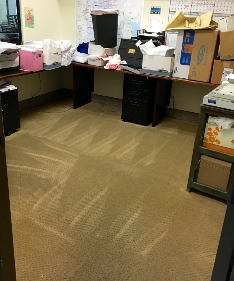

post the After of this area..
I don't like the way they vacuumed some of the offices at the end. Usually I don't leave the triangles but since it's commercial it'll be walked on soon enough.
This entire place actually has Berber carpet in every room.

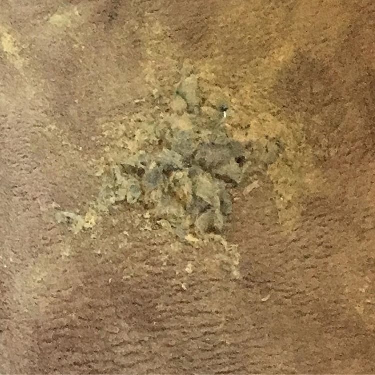

For example, this is one we would HOST after agitation of prespray. Gotta make sure you don't miss any spots or discoloration before HOST. HOST seems to cover up small spots and stains you might miss if its bad. If you scroll down our insta page, you can see some of the clumps of crap HOST pulls out. https://www.instagram.com/naturaldry/
