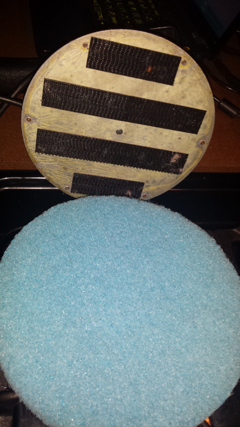

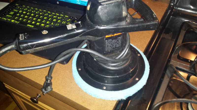

If you can find some type of drive plate for it, you can put strips of Extreme Scotch Velcro and attach scrub pads and bonnets.
I use 8" pads from DrillBrush, and Cimex type pads are 8" also I think.

Goomer is right on. Harbor Freight sells 6" drive pads for polishing and they work wonderfully with homemade pads cut from the bigger ones. I use a knife to slice the disk at a shallow angle, making an edge that gets right into tight spots.
