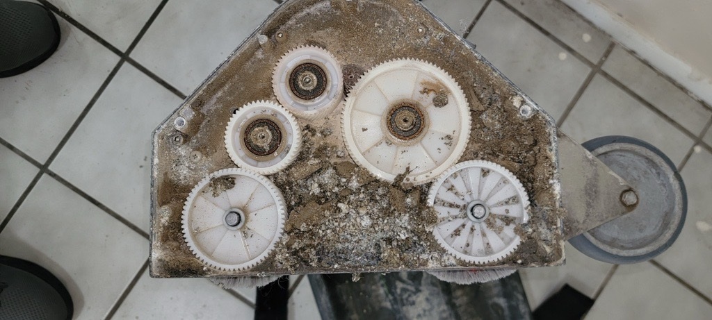

We're doing 4-6 jobs a day per truck. Rarely, if ever, use the CRB's on carpet. Primarily used to agitate T&G and occasionally on a really dirty commercial carpet. We have the Austrian made PRO35's in 4 of our 9 locations (a total of 25 CRB's in total). YTD that's 2,700 T&G in those 4 locations.
I do feel like we go through a lot of gears but I suspect it's just a matter of numbers. Be purchased our first 5-10 units in 2018 and the remainder are probably 2 years old...
When we open the side to expose the gears they are nearly always filled with debris and garbage (See attached image). We probably clean that gear area out 2-3 times per year. We likely need to do it more frequently.

That's a sure fire way to wreck gears and bearings. Like all machines, CRB's require a level of maintenance. Open up your CRB's and clean them regularly. We recommend wiping everything with with WD40 to clean and protect from moisture.
Whenever we occasionally service CRB's like the one in this photo at Excellent Supply, our repair tech cringes! Show your CRB's a little love – after all they're making you money.
This may help, Gear & Bearing COMPLETE KITS:
