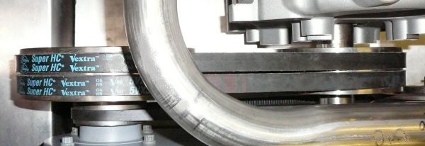

FAST BELT CHANGE

We are noted for our fast blower belt changes.
Our TM mounting plate will flex enough to change out the Gates blower belts in ~10 minutes.
You have to roll the belts off and on, but that's the way most of our customers perform the replacement.
Larry

Seriously Larry, you think a flimsy mounting plate is something to brag about? Maybe if it didn't flex so much belt changes wouldn't be as frequent.
X2

So.... The engine and blower are bolted to the same piece of steel, but it flexed enough to change a belt? Not picking on you Larry, just trying picture this setup.
