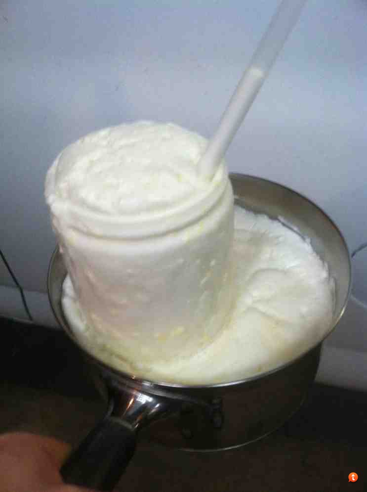

Jus a lil defoamer hell! And all she could think about was the danm pan!
Dang what a thrill : )
Snapped this as i was runnin outside.
Dang westerners an deir crazy ideas : )
Sent from da bak seat of a Purple Caddy where the roadkill is real : )

I ain't eatin at yor house Chris.
Hell naww!
:p
WTF is that? A jar in the pot? :eekk:
That is Oh Shit, Doc!
Much gooder now that its had overnight to relax a bit. Came out well so far : )
More for me : )

So what part of mix it sloooooooooowllyyyyyyyyy didn't you get? Slo or wly?
:lol: :lol: that looks messed up.
Slo or wly, tha whole thing
It was like a Mad Science project at first man, lemme tell ya : )
Funny how it turned out like Tacos huh?
