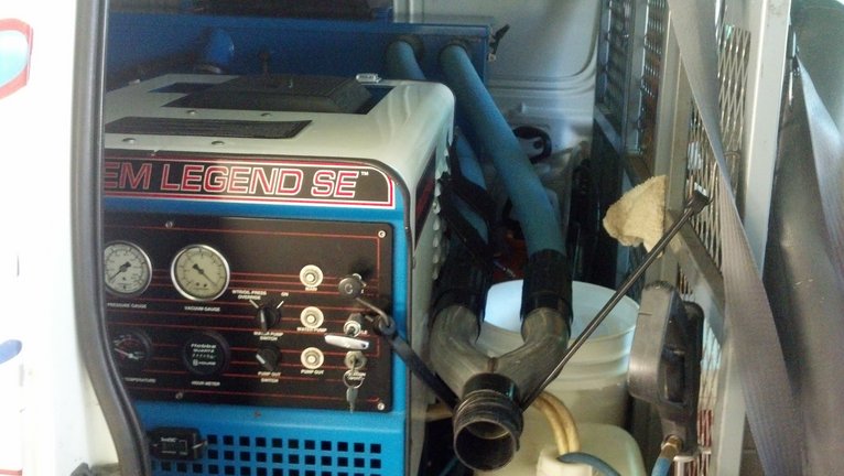

Matt,
Yes you can. Here is a photo of my PC Legend. As of now we have been running one 2.5 hose you can see in the picture how we have the Y. If I need to we can take Y off and go back to 4 2 door set up. We are getting 350+ cfm at 100 feet. You can get some really good performance out of your PC L.
