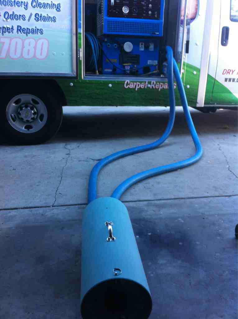

Best filter IMO

if i had to buy one i would get the one John built out of poly. assuming its still available.
