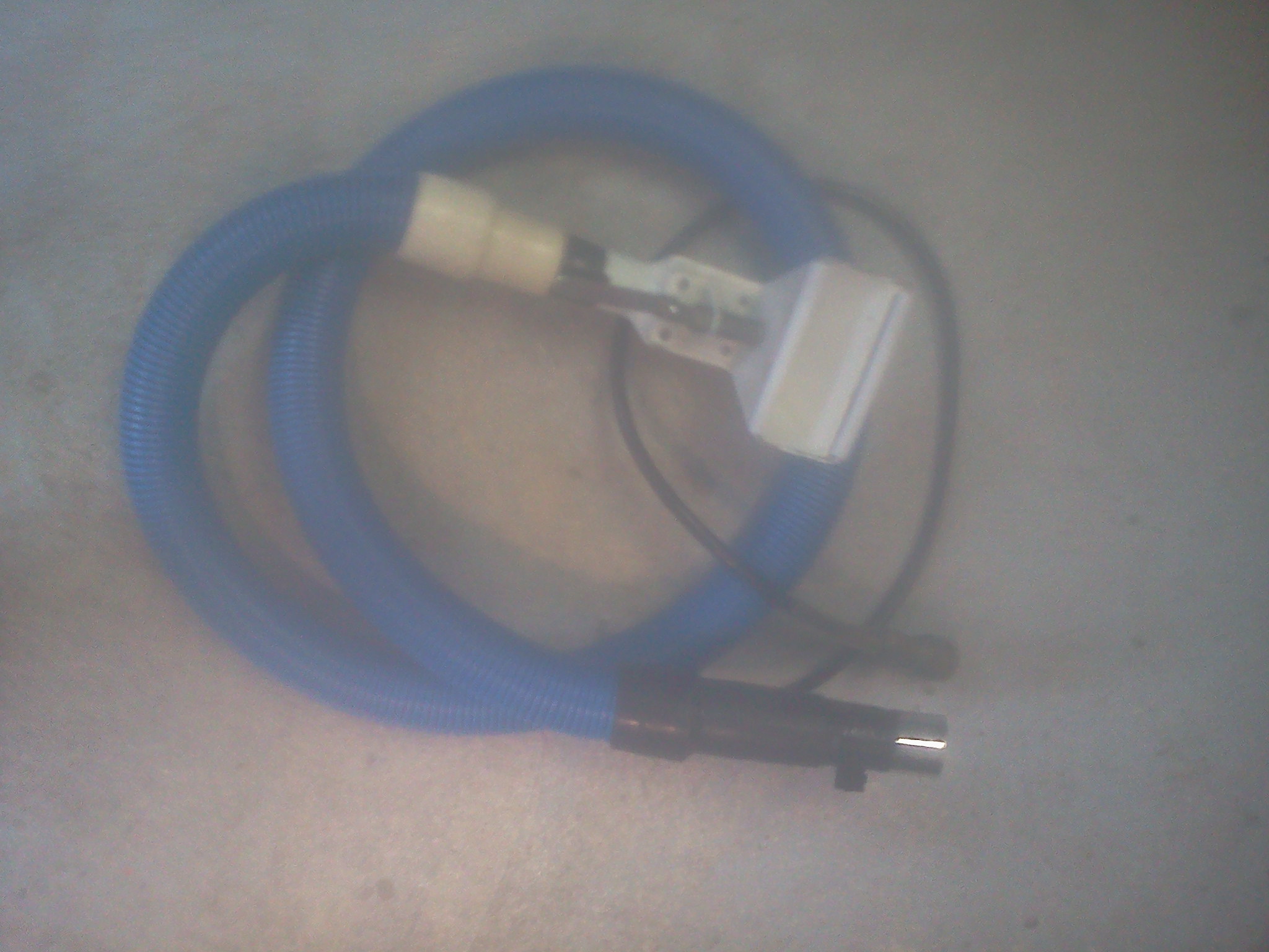

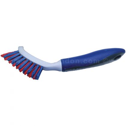

Kleenrite BlackOut Grout Brush and a old 4 '' SteamWay Stair Tool. I have a Crevice Tool but it doesn't flush very good and it only covers about a 1/4-1/2 inch out from the wall. Many times the filtration soil is wider than the crevice tool so a 4'' stair tool works better. Yes it means getting on your knees but it just does a better job and you can move faster. I run the side of the stair tool along the baseboards. I get good results and do charge extra for this work. BlackOut rinses easier than the gel type spotters for soil filtration.

It works great for tight spots. Between beds and dressers or cleaning the edge of area rugs. It puts out a lot of solution and works great for flushing/cleaning soil filtration. I don't use it for stairs because it's too small and slow.
