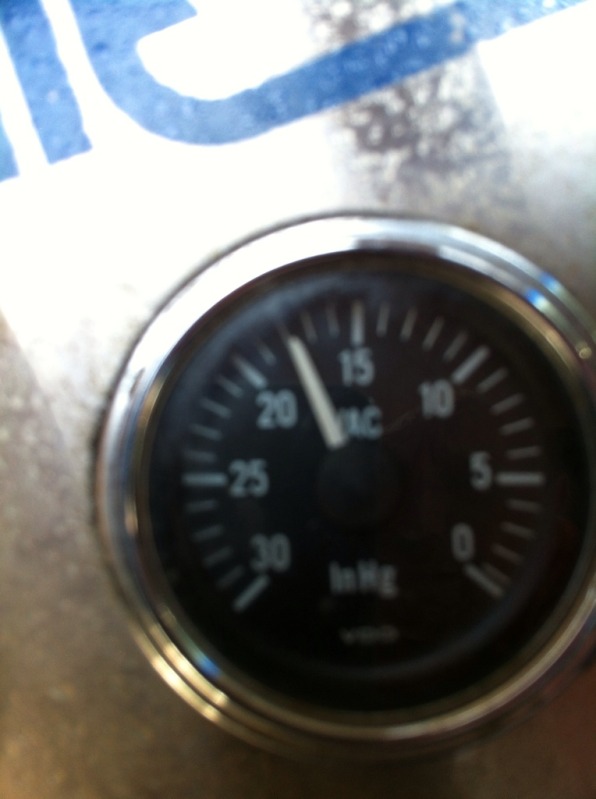

Same here Bob but ours is at 18Hg.
AshleyMckendree
Sep 1, 2007
1,572
Versailles ky
Ashley Mckendree
even tho i was only running my truck engine at about 1600 RPM.........i suppose the 47 blower was spinning at about 1900 MAYBE 2000 RPM......
on complete lockdown of the waste tank including the spring relief valve...( duct taped shut )
i could easily hold 16 Hg........
madder a fact...CRASH posted a picture of his vac guage at....16 Hg....when he first bought my unit!
