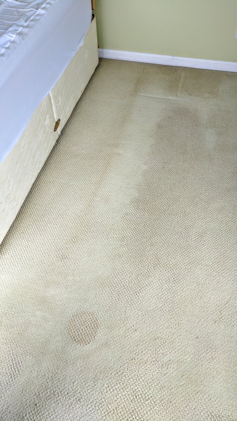

Freaky Berber distortion
Cleaning Professional
117,387
Never seen this before..
The round spot was where a large bed post was.
The light streak down the middle is what got me...
Not effected by the cleaning

Noticed the furniture indentation marks next to the wall. The furniture has been rearranged and the light streak would have been where the edge of the bed was before. Looks like the tips are bloomed from over agitation either from a cheap vacuum or a carpet dry cleaning method. Working up to the edge of the bed and reversing.

Looks like wear to me you idiots....crushed fibers from abrasion........

the right side of the white area shows a dust ruffle outline. don't know what that means.

You ever seen a poly nylon blend flecked berber where a chlorox spill really moves the flecking only?

Yes I have. 2 or 3% nylon accent color bleached from a 97% polypropylene carpet.
