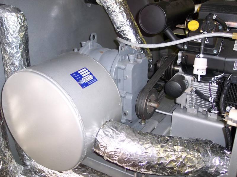

SILENCERS,
WE HAVE USED THEM BY THE 100S ON OUR INDUSTRIAL SYSTEMS
We have them available from Stoddard,Universal & Cowl.
All are options on our machines.
Why on the TNT,Dynamax Super Turbo,$53.45 @ Advance Auto Parts,
Stoddard G-31 $770.00.
Example;
El Diablo current published price. $15,995.00
TNT-SS with #3 High pressure heater. $12,995.00
For $3,000.00 you can add many options.
Good luck,Judson

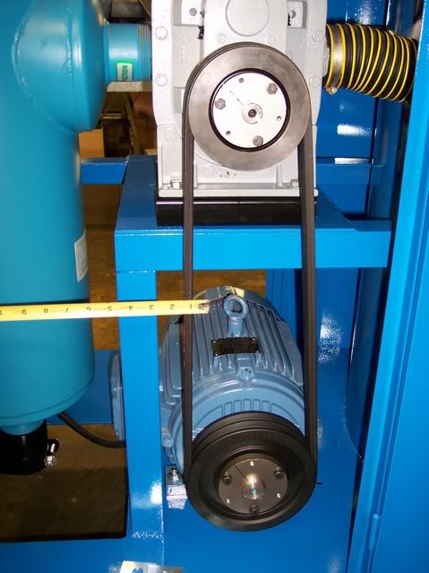

For the record... The new systems don't use a broken metal plate frame. I did away with that about 2 years ago. It wasn't for reasons related to coupler longevity. It had to do with ease of access to the pump- out pump, which was the one thing that was a PITA to get at when necessary. And I hate that. So, I shifted the design in order to address that.
You hear that I'm "going back to" belt drive. "Yes", and "No". "Yes", I'm building belt- drive systems now. "No", I haven't stopped with direct- coupled. But then, I never completely stopped with belt drive either. It was just relegated to the SplitSteam design, which we didn't receive an order for.
There was an issue with belt- driven systems I made for a brief period. That period was in 2000, when the V2 systems were out. There were 6 of them in all. But only two had belt issues. They were both SledgeHammers. And the problem had to do with the blower plate, which I had designed to be movable, in order to accommodate different- sized blowers on the same frame.
The plate on the SledgeHammers continued to move when it shouldn't. The reason was that the torque required to turn a 47 Roots was enough to move that plate, too, since the blower was secured to the plate. It was unfortunate, but easy to correct via having guides on each side of the plate to keep it in alignment (which is a feature on the motor plate of the direct- coupled systems I subsequently designed...). Prior to that specific design, there were zero belt issues, in the Hammer, SledgeHammer
(That's not me, by the way...)
or PowerPak systems I designed.
(That's not me, either...)
After that brief "Hammer v2" design, there were none, either.
The reason I came up with the v2 design was a preparation for the heat exchange system I was designing at the time. It was premature, all things considered, but the design itself was sound, except for the undesirable mobility of that blower plate..
The new belt drive frame, by the way, is the basis for the Nemesis, and Accelerator and Dominator systems.
The direct- coupled frame is for the Xcel, Predator and Predator Unleashed systems.
Regarding car mufflers... Back when I built Hammers, I used them exclusively. I did try Stoddard silencers (and Phillips Temro and GT Exhaust) along the way, but they simply didn't give the sound reduction I expected and they took up too damn much space on the system, making the system have to be bigger than I wanted. (In case you're not aware of it, one of my design parameters has always been keeping my systems as small as possible, yet uncluttered. (Three- foot long, 10- inch diameter and larger silencers seriously interferes with one or both of those parameters.) In addition, they cost considerably more. So, why pay that much for something that shifts the footprint so much and doesn't work as well as I'd like? Especially if I can come up with a better way.
In addition, silencers do not necessarily last as long as they should for their cost, IMO. (I had two systems with Stoddards on them in my shop in the last two weeks, rusting out, at about two and three years old. A car muffler has a similar life span at minimum, and typically more, on a truck mount. So there's no advantage there of a silencer, either, from what I've seen. (And mufflers are much easier to replace.)
At the same time, I have noticed in the larger blower sizes that a single car muffler is inadequate. So, I've come up with a solution to address that: two of them in parallel. The difference is pretty damn impressive. You'll just have to take my word for it for now, I guess.
