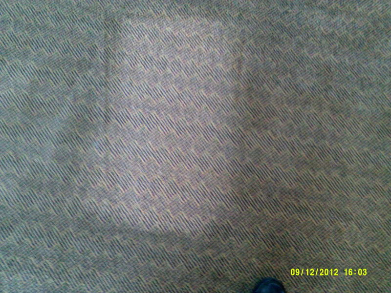

Just an emulsifier, no prespray did this. Double wet pass, double dry. For those NOT using an emulsifier in your rinse:
A) - What aren't you getting out?
OR
B) - Why are you working so hard?
Hold the canard about "residue", at an ounce or so per 5 gallons RTU, with an 80% or better recovery rate, that's a red herring.
what are you leaving behind
rub a white towel on it to see for yourself

I use to clean with only an emulsifier and upon switching to pre treating, agitating and rinsing found it a much better and faster as well end product. But you can clean this way, but on dirty news you will have trouble compared to a proper pre treat/ agitation IMO

And run a clean terry pad over it with a rotary/op machine and get out even more. Doesn't matter what your using, it's still going to have some soil left behind. Unless there's a magic formula I wasn't told about.........:dejection:

To me it looks like that "clean" line is all pinkish or whatever color.. Which makes me think the original color of the carpet should be more of the bluish color around it. :confused: So is this a test, where you are testing the reaction of the expert herd here and the carpet really is just a damaged piece that you came accross? :icon_twisted:

That, indeed. Big Z is the actual colour of the carpet. No prespray, 2 wet 2 dry, 350 PSI probably around 180 or so.Ninja Worrier 500, dual 3 stage, Kleenrite Heatrite 2 , modified from 190 thermostats to 2 sets of 220, 50 feet 1 1/2 inch hose,fixed grey cuffs, Goodyear Neptune, 15 to the heater, 35 to the wand, Parker fittings, male to machine, terminal female,ball valve, AW29, soft touch valve,2 1101.5's, Greenglide hybrid. Did I miss any details?

Sounds good, I would have bet on that line having a bit of a "bleached out" effect and the bluish around being original.
Good job then. What is the Emulsifier that you used there?
