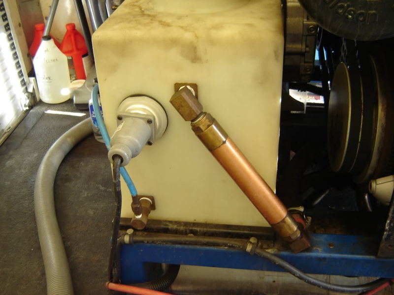

Mine broke when it was fairly new and here is how i fixed it. 9000 hrs later no problems.
gene
