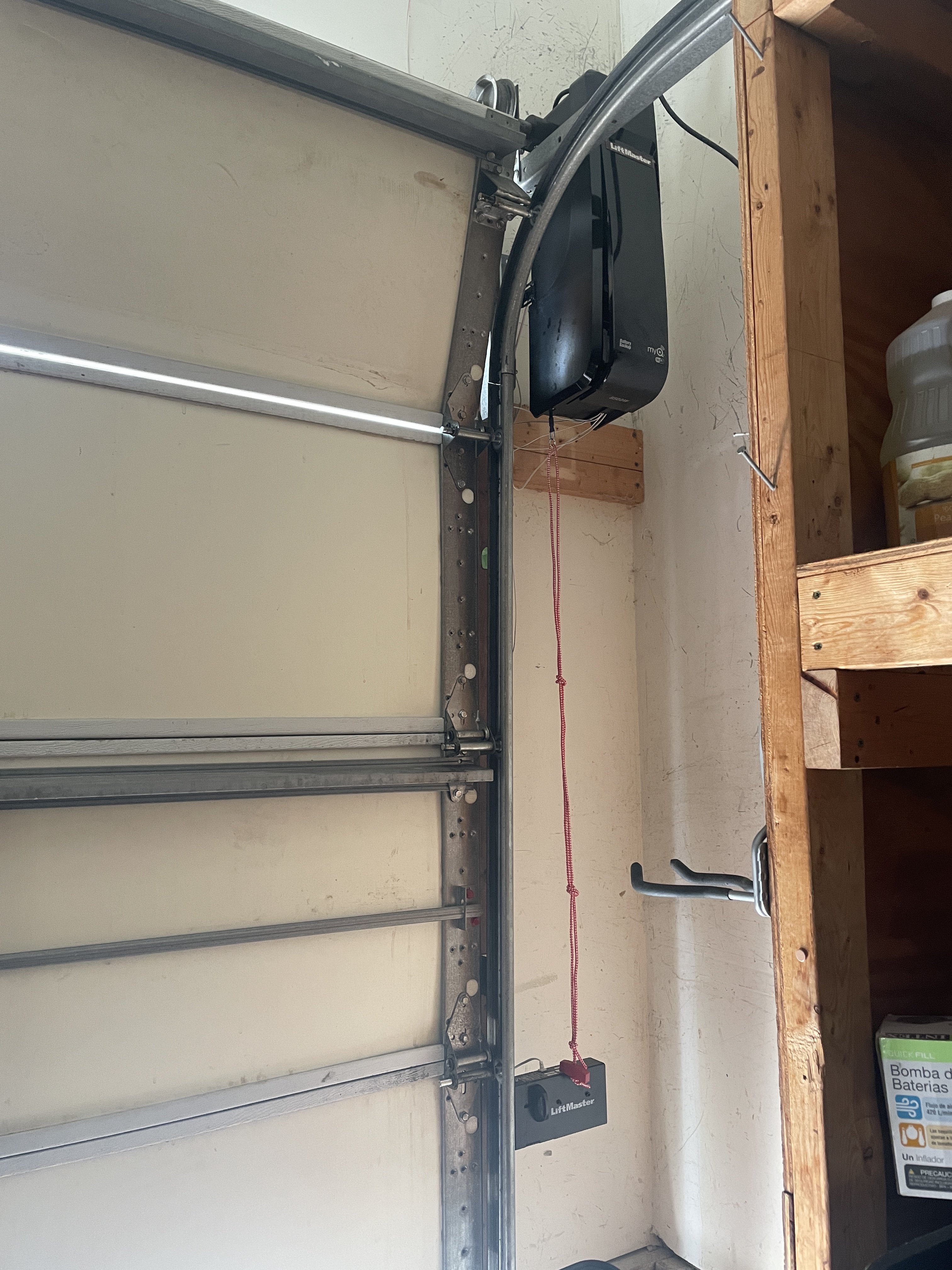

Thanks Papa John, its not an issue now because it makes sense to keep my 2016 inside, especially winter, and the new Truck will be in driveway with no limits. I just got a new door opener. No track it just mounts to the side of the bar on the wall. thing is sweet.

🤔 Interesting. Can we see it.
The bottom black unit is the lock. After it shuts it locks. Plus it has like 15 lifts if power is out. Obviously (these days) comes with app to remote control, and lets you track it if you want to.
This particular door is a little heavy for regular lifts, and can handle twice this door. Quiet. Love it.
