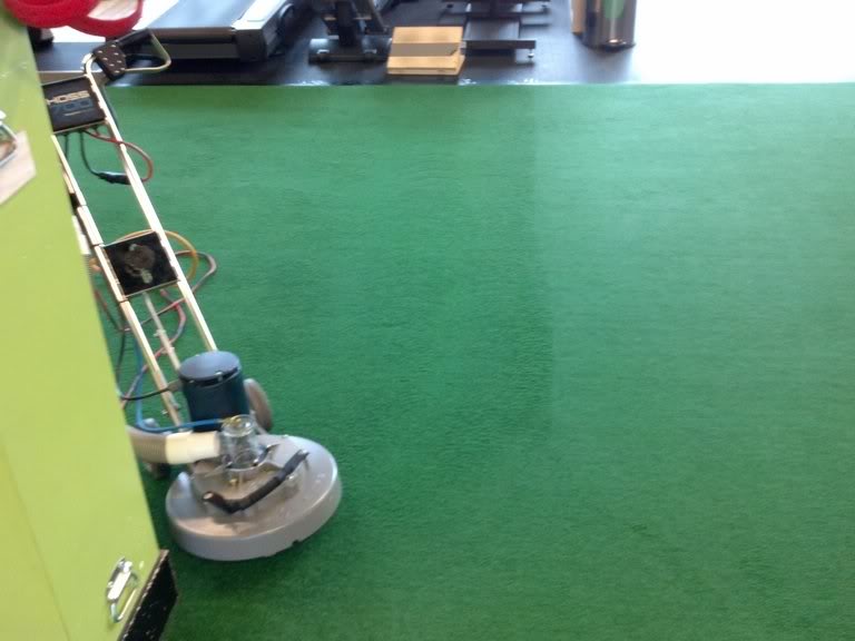

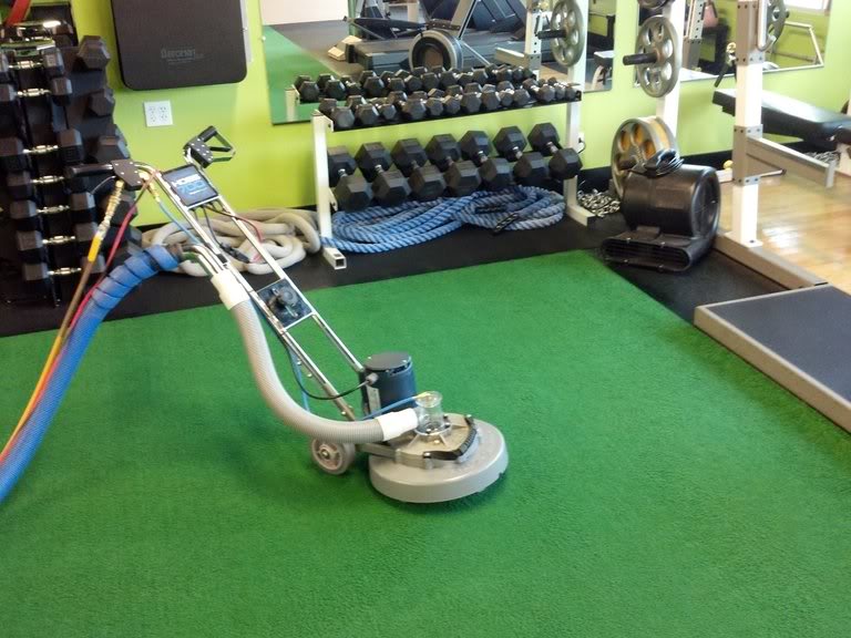

Gave the HOSS a good work out at the gym
114,115
cleaning some Astroturf..
The ol' wand was just not fluffing it up like the owner had hoped for.
Much fluffier!
and of course it was digging junk out the vacuum and wand could never get.
The concrete underneath had a few bumps and the floating heads did OK.

The handles look fine... From the picture , it looks like the solution line connection and power cord should come off the machine lower. Closer to where the vac port is.

Power cord just looks looped.

I saw it at Mikeyfest and some of the guys using it say the handles stick out too far for resi doorways and such.

its not the handles that are a pain..it is the connection that you hook your 2 inch hose to...it needs to be more pointed at a downward angle....
The handle width is a bit wider then the other rotaries but it is way more comfortable to run....if the hose connection was fixed then you could manipulate thru doorways just as easy as all the other ones......but because of the way it sticks out it makes it a bit harder.....not impossible...just a bit harder......
