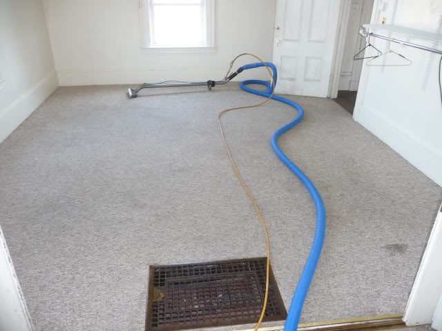

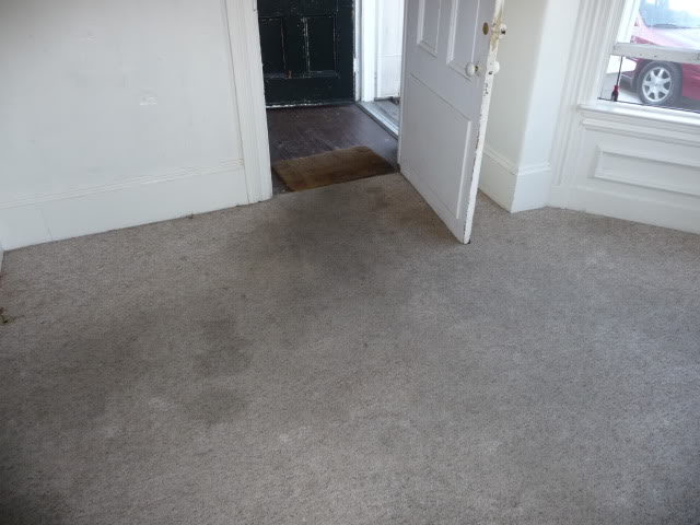

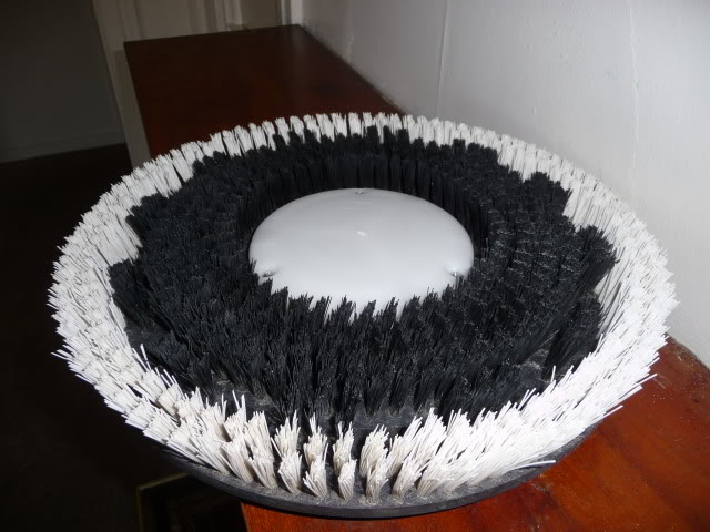

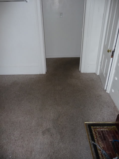

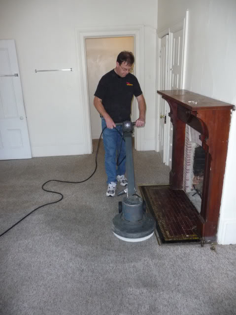

Ghetto but I gots my new shampoo brush.
117,369
after shampooing , before rinsing.
I owe FIddy an apology.
A Shampoo brush does work every bit as well as a Fiber Pad.
But I'm not convinced yet that it's better.

I don't have any idea who this thread was directed at, but you seem to forget that it has been ME, the king of pork, that has been telling you to get a shampoo brush for years!
On residential cut piles, it's better than a scrub pad.
On CGD, the pad is best.
I never get any credit around here!

Looks great Mike! Glad we could be of help. Did you break the brush in before use?
117,369
Yeah, I left a real clean spot on a asphalt drive way @ my Realtor's office :shock:
I should confirm what Marty said, it works about the same on Berber but better/deeper on piles.
Especially a 80 ounce plush we did yesterday.
p.s Marty, if you ever want to be taken seriously, ditch the Castex's are great wands comments

The same brush that Mike got from us will fit your Powr-Flite 17 inch. Here's a link to the brush;
17 carpet scrubbing brush with glide
Your cost with the 10% Mikeysboard.com discount, would be $73.94 plus shipping. If you need the discount code, please let me know.
