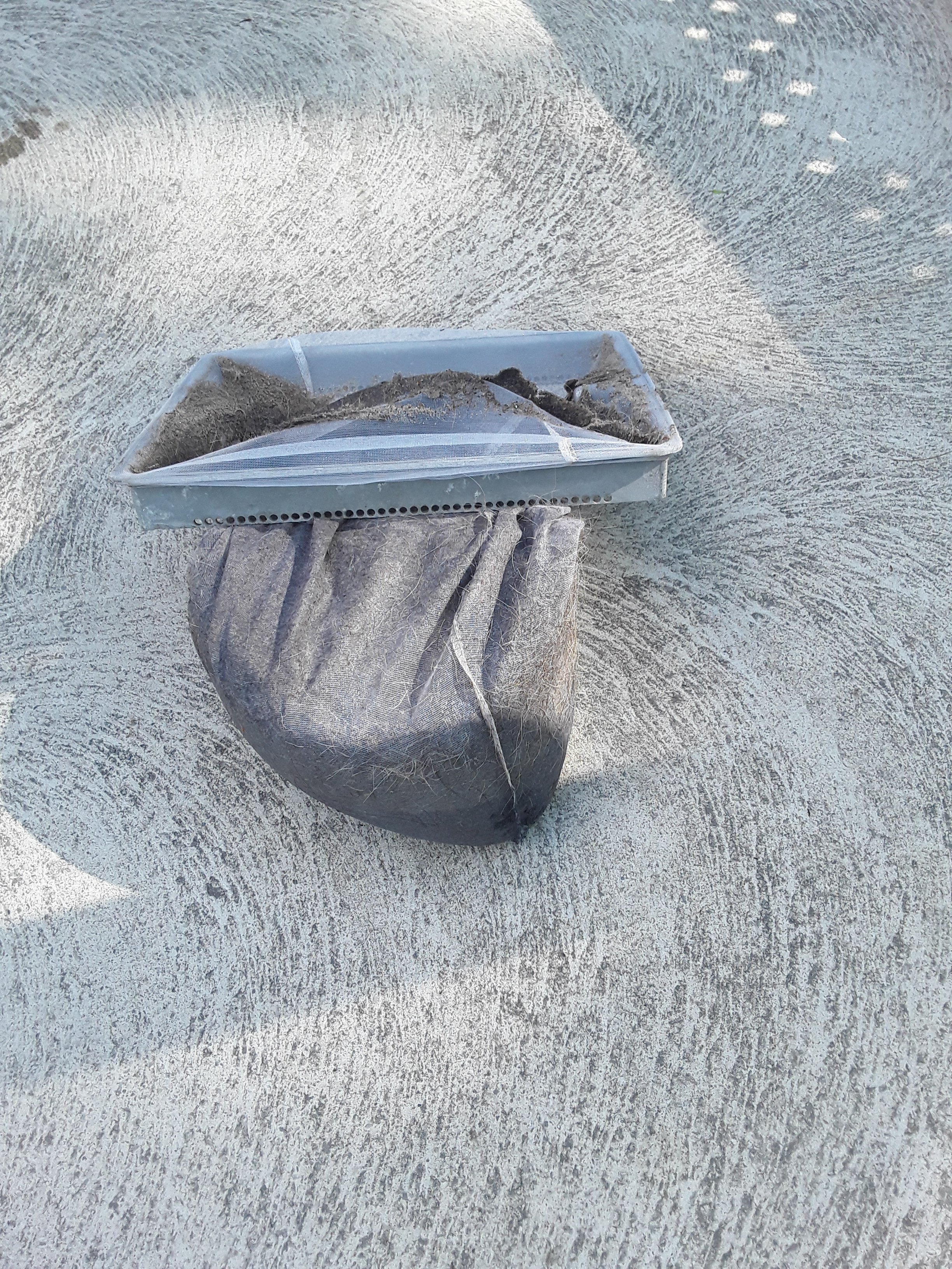

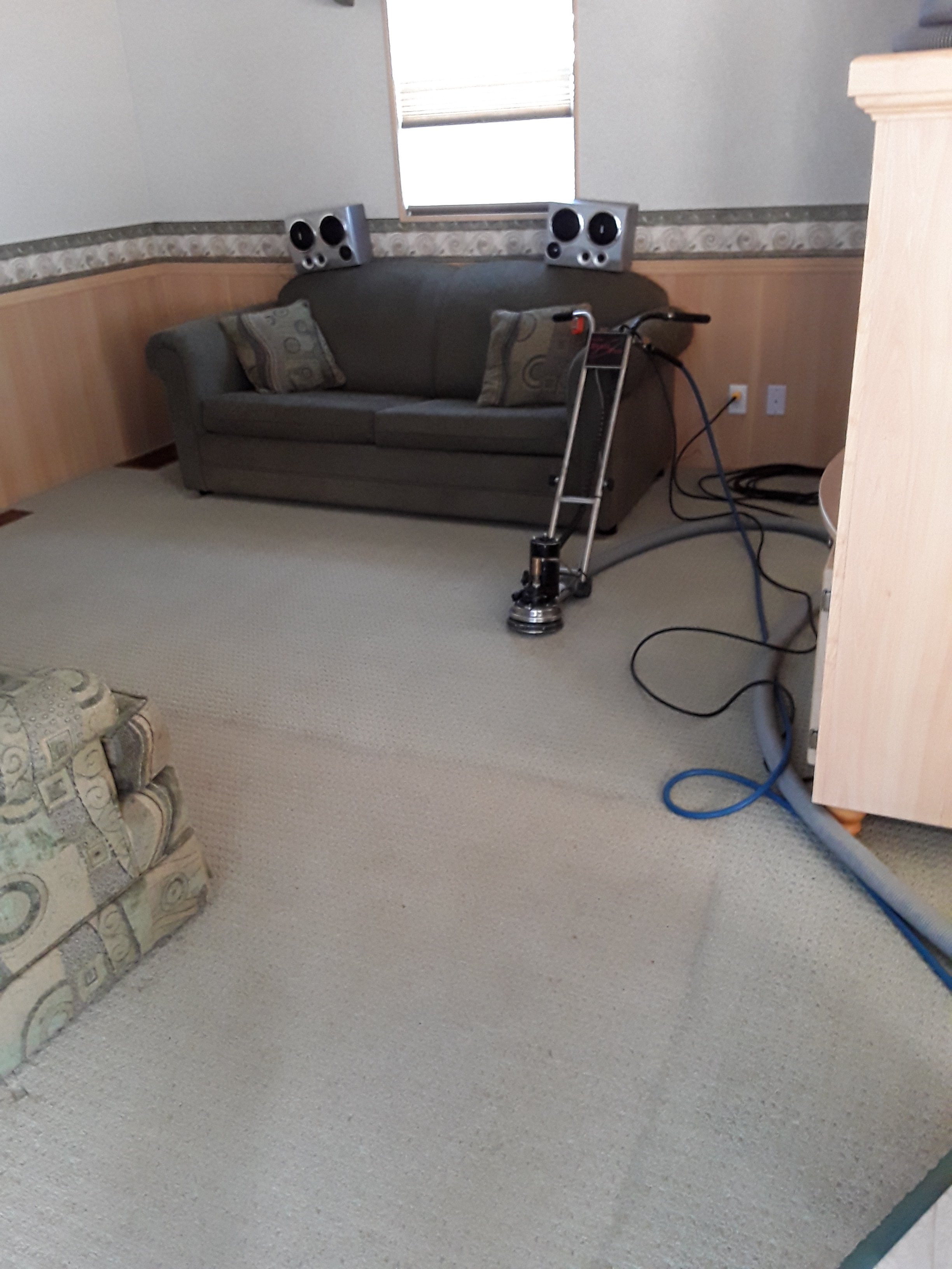

Water is a rinsing agent. And by itself can remove all kinds of soapy residue. It does clean by itself and has been proven to be very effective with the proper tools.
