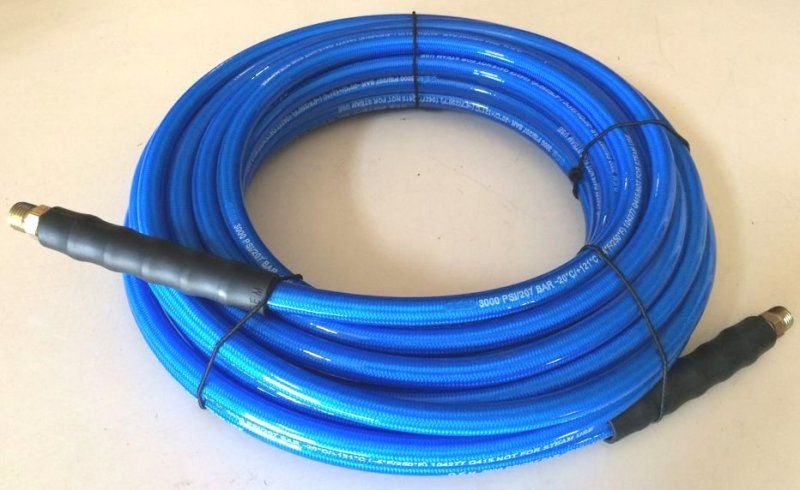

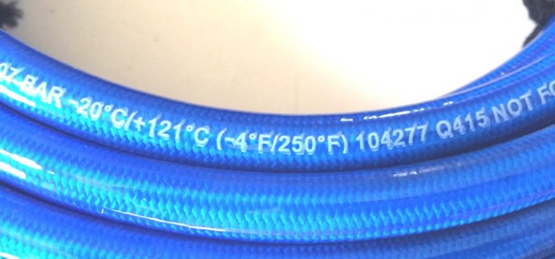

This new 250 degree Blue Thermoplastic solution hose.
Insulates heat well and slides easier on the carpet.

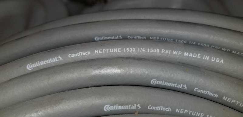

Goodyear Neptune with the nylon braid. We also have reusable fittings that can be changed in the field.
Our hoses last several years as well and these are all employees.
Wow, Brian. I didn't know Goodyear had an all plastice hose. Where did you get it?

Steve;
Thanks for those kind remarks.
"I am just saying you don't have serious issues with this hose because you are using it in low pressure applications which is a lot different than TM users."
I understand what you are saying however, allow me to clarify one very important aspect and consideration. The Neptune psi hose was selected because many of the operators whom purchase our equipment also either use propane heat, and/or use this same hose on their TM's. Thus, no problem of holding up. Further, underneath the ETM Jaguar 8.4 system, we utilize that same Continental Neptune hose (3,000 psi wp) x 3/4 which Brian mentioned because it lasts forever.
Maybe we are a little different than some at our end because after being an actual user in the past, IMHO, operators of today do not deserve anything less in an industrial machine. In other words, they do not deserve problems and break downs.
Once again, you are a real Pro and always have been!

Our new hose is rated 20 degrees higher temp than the Parflex (& rated 3000 PSI).
Plus it is more flexible
I have been using Larry's new thermoplastic solution hose with my high heat Butler. I use Butler's live solution reel that coils the hose tight. The hose lays flat even on these cool New England mornings. If Larry's new hose holds up as well as the Parker Parflex that I have used for years, it will be another board favorite.
