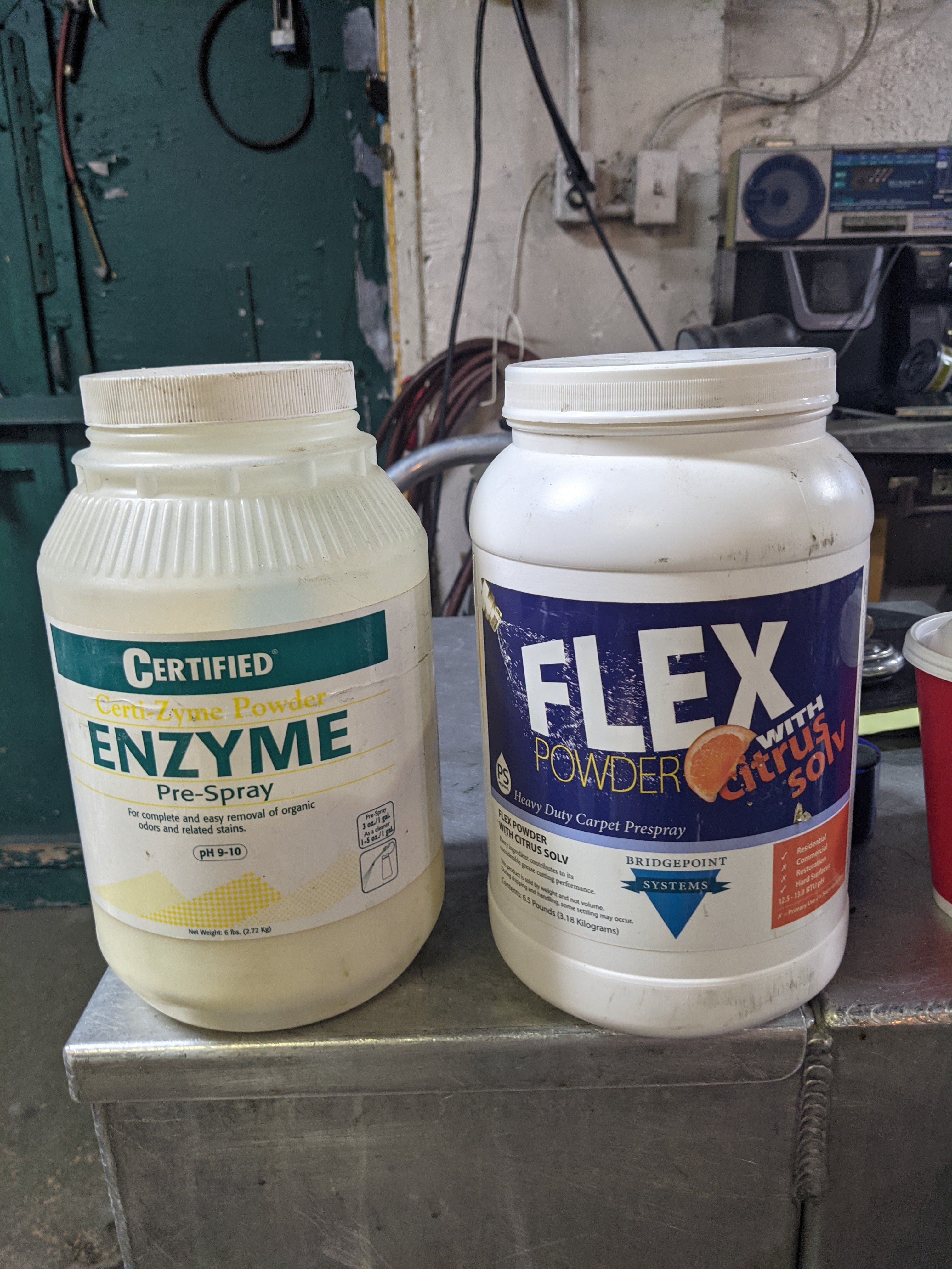

Bridgepoint has a product called Flex powder. Very strong and doesn't foam.

I would agree with that. I've used Enz All in the past. I don't do a lot of greasy restaurants any more.
