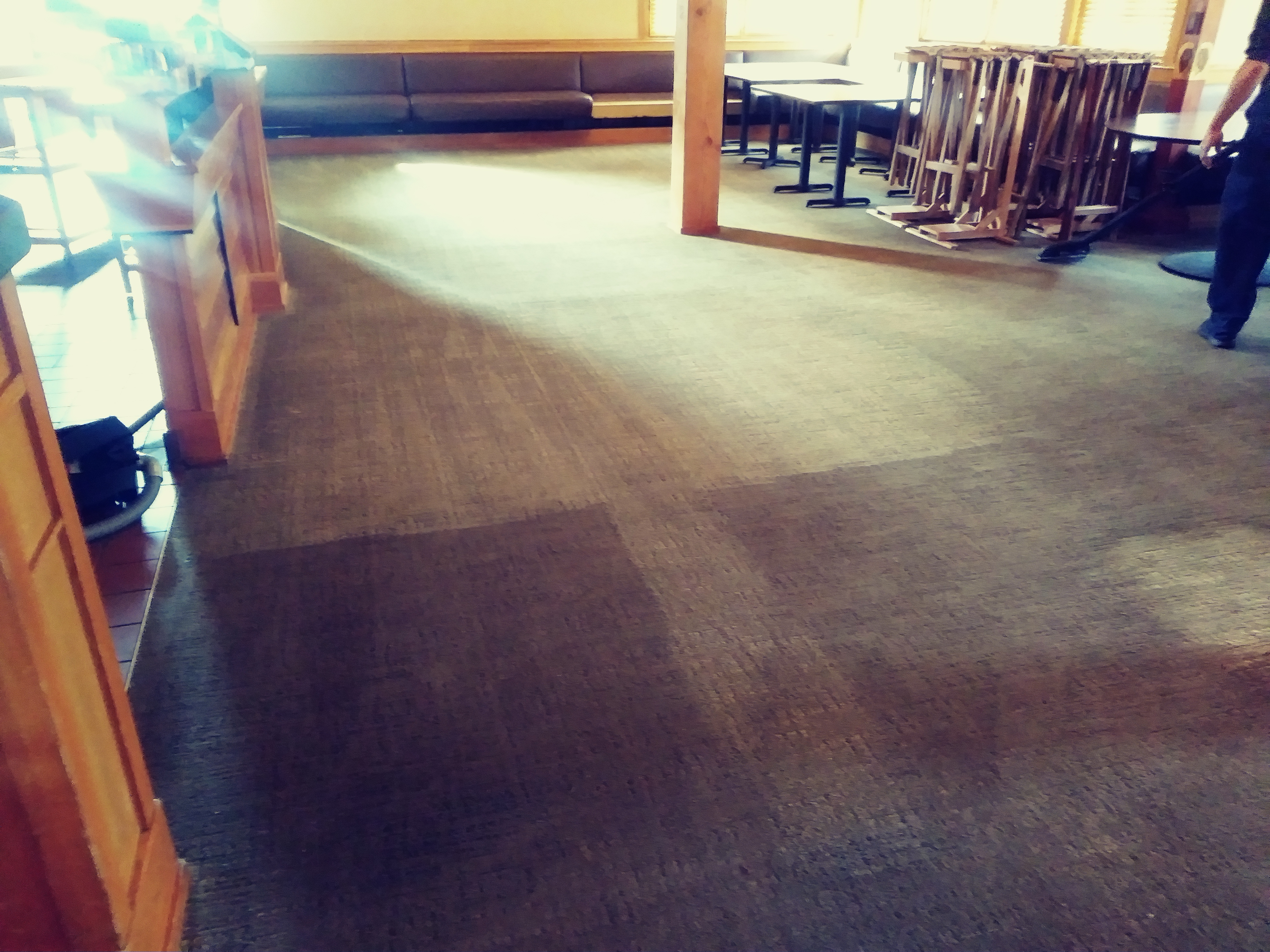

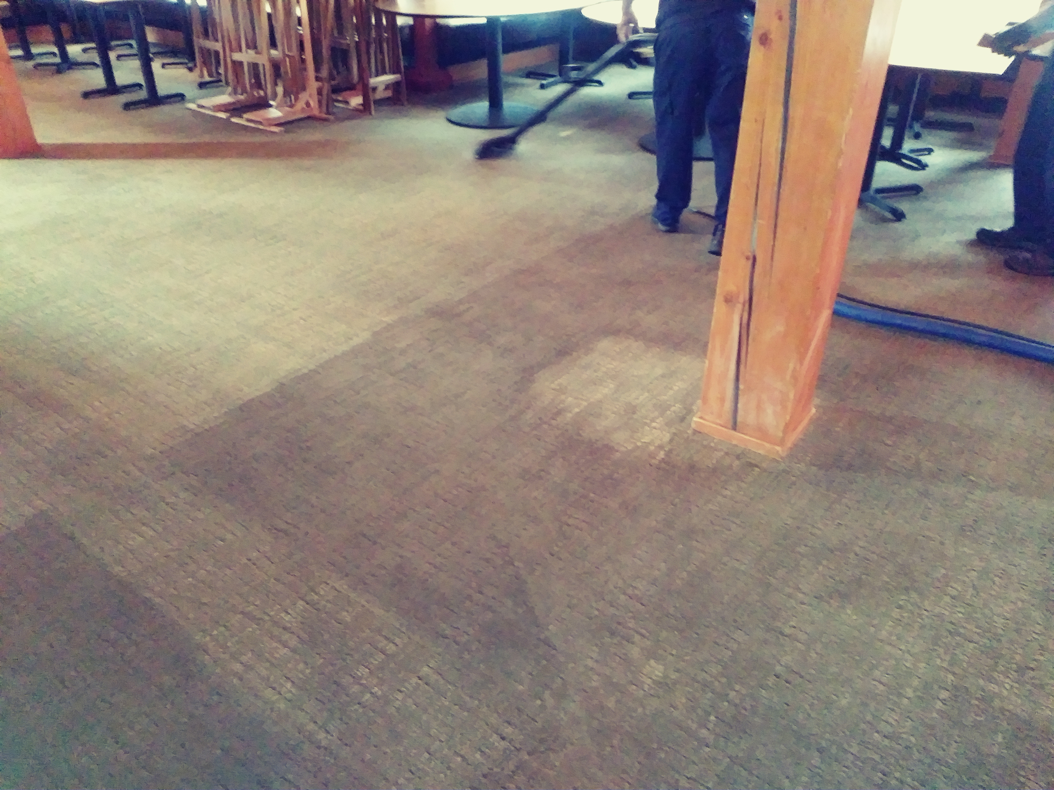

I recently tried Bio Break w citrus Solv as a prespray and rinsed with Flex Ice. It worked much better than my current Green Balance products. My problem is my company will not approve the Bio Break and Flex due to environmental regulations as we are in Yellowstone National Park. My question is can i achieve similar results with either Procyon Plus or Procyon extreme?

Steam Way International is near you in Jackson Wyoming. They can help you out with quality chemicals to fit your needs. Their phone number is (800) HiSteam
28,177
I use procyon as my go to for residential and for some commercial. Rather than making your chemical do all the work, it's better to add some agitation like a crb. I use procyon extreme as my prespray and rinse with procyon plus powder. Gives me a great one-two punch and the pH is near neutral when I finish.

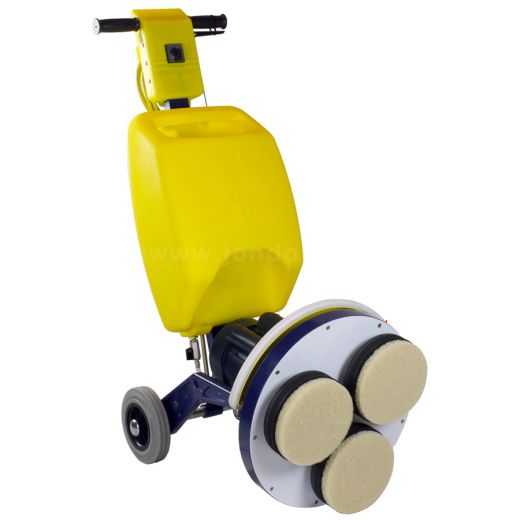

They are keeping me happy. They gave me samples of the bio break and flex ice. They worked great but my company is very hesitant to approve them. Vendor is giving test samples of Procyon to test next. I am also bringing in a crb for agitation so that should help.

Rent a Cimex for a test, It will improve the results of any pre conditioner used exponentially.
Then management will authorize purchase of one when they see what you have done.
