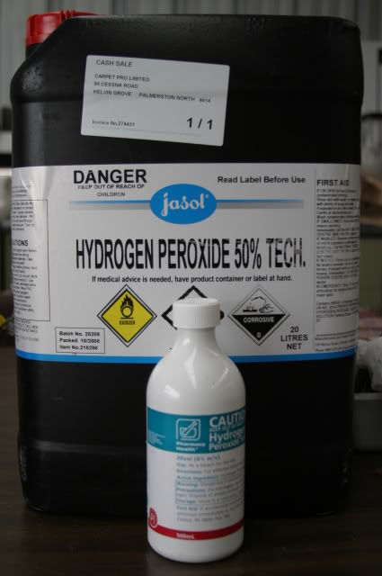

John
Larry Cobb said:
John;
It would be foolish to buy it @ >50% concentration.
Heat and slight contamination can cause immediate problems. Have you ever seen a drum rupture from overpressure ??
It is also in a higher hazard class (UN2014).
The safety agencies would demand to see your HAZCOM training program, if you had a spill.
Not worth the combined RISK.
Larry
John

John;
It is still dangerous....
Quote from a manufacturer:
"Small amounts of other materials that contain catalysts (silver, lead, copper, chromium, mercury, and iron oxide rust) can cause rapid decomposition and an explosive pressure rupture of the containing vessel if it is not properly vented."
Larry

John,
You live in a wonderful land with few guardrails, because if you're stupid enough to drive off the edge you deserved to crash. In the US, anyone connected with a misused product gets sued, and everybody pays.
