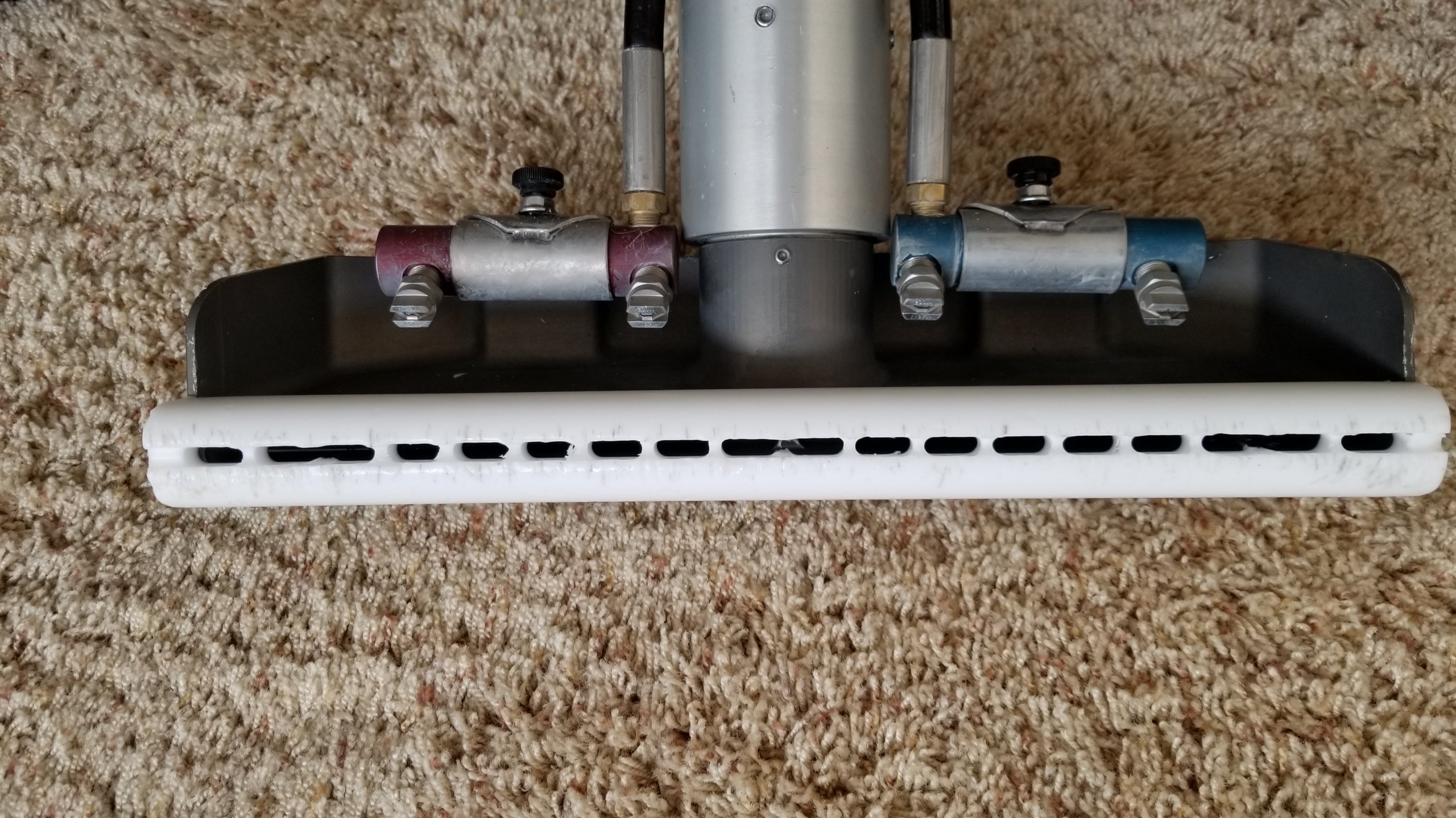

No more slot streaks.
CRB lump pick up.
Noticable increase in extraction/ performance.
11,013
I've done the same with my PCTI worked great. I did deepen the center groove though, to allow more suction.
I actually find his slot glide to be much better than the regular PCTI slot glide. Wider holes etc.

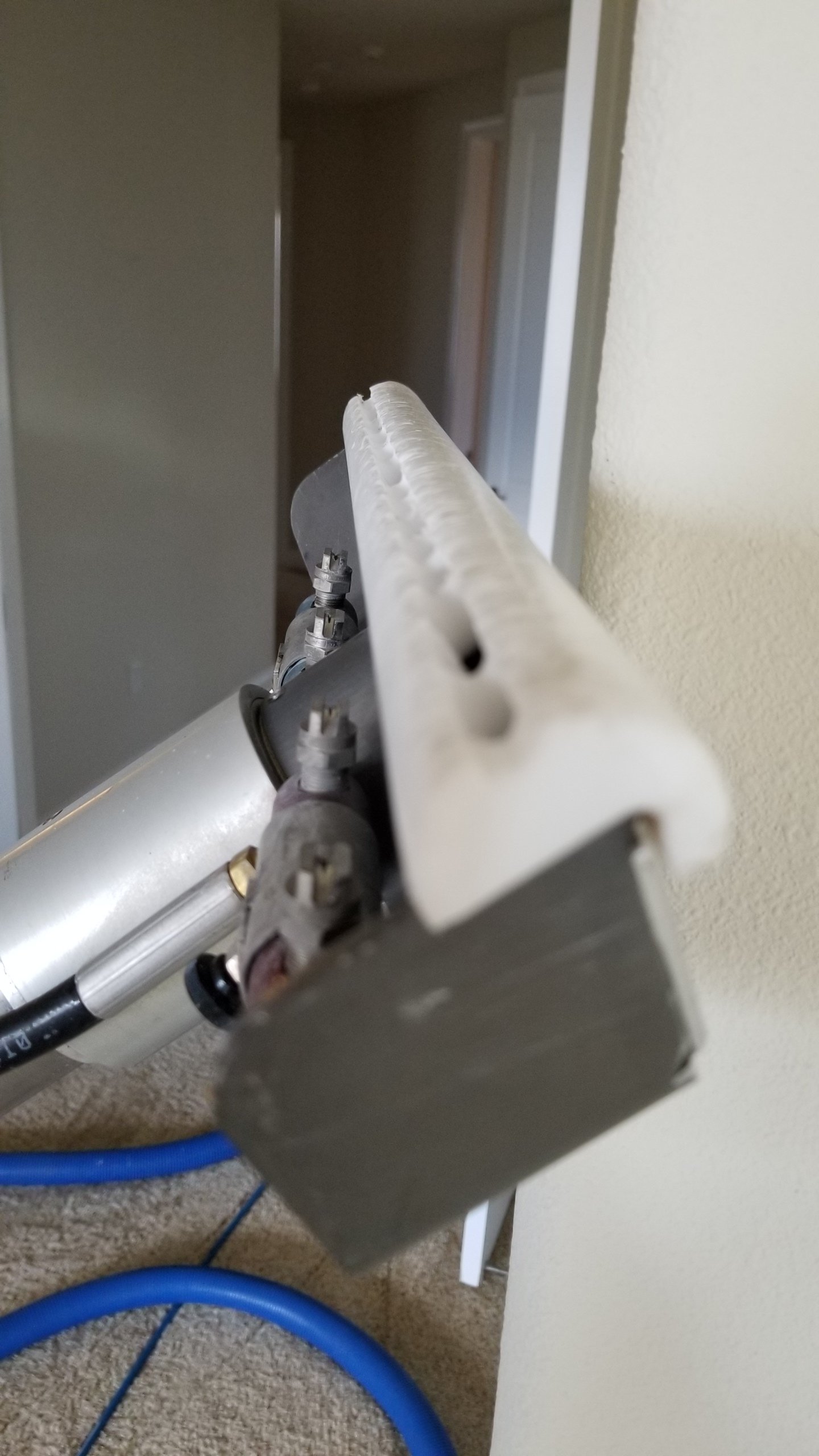

Why not go total slot glide.
Seems to me more pick up of gunk and airflow is neglectably minuscule to hole glide.

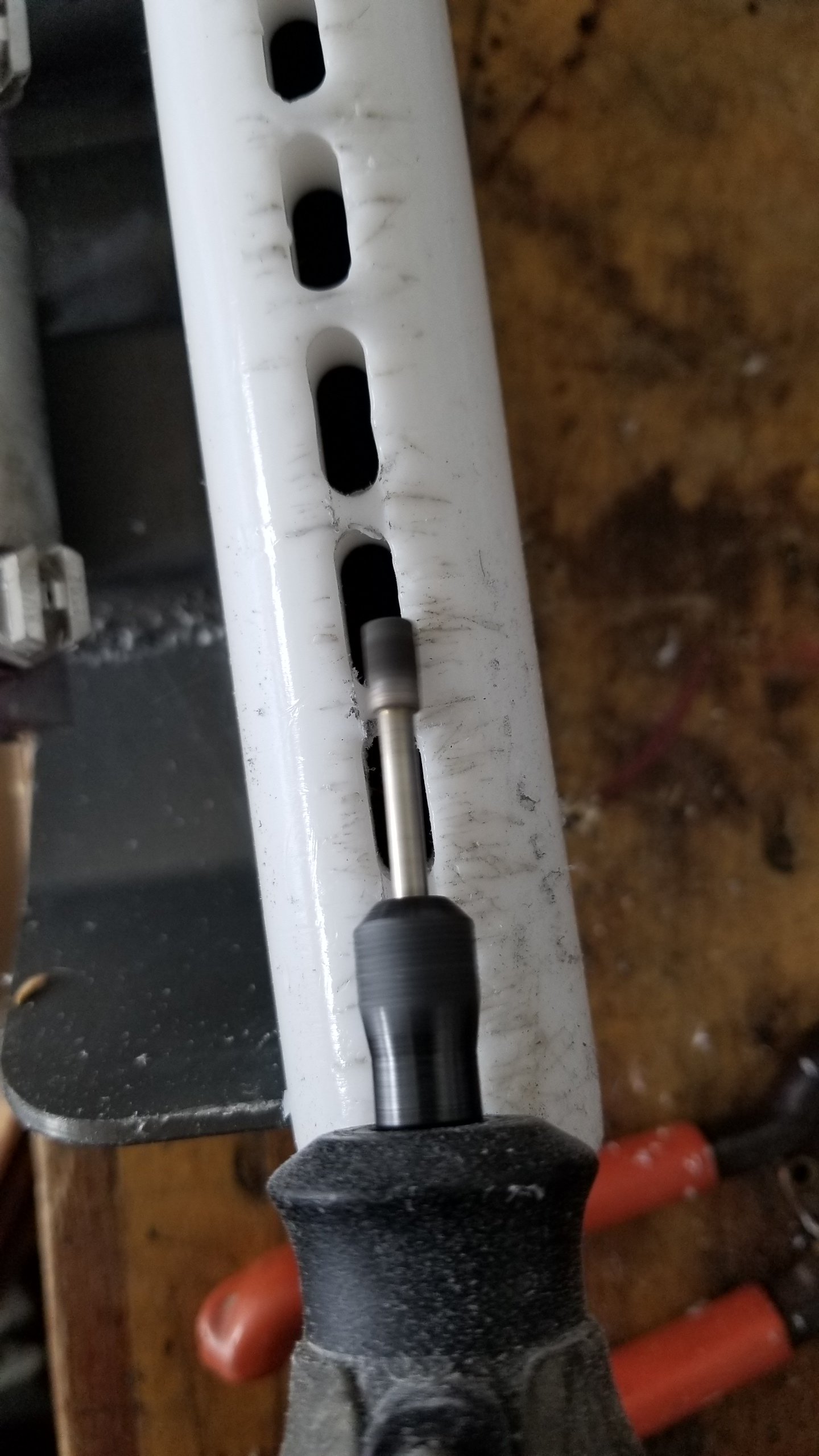

20171110_085509-0-jpg.75609
Which Dremel tip is that??
Cutter or daimond wheel?
