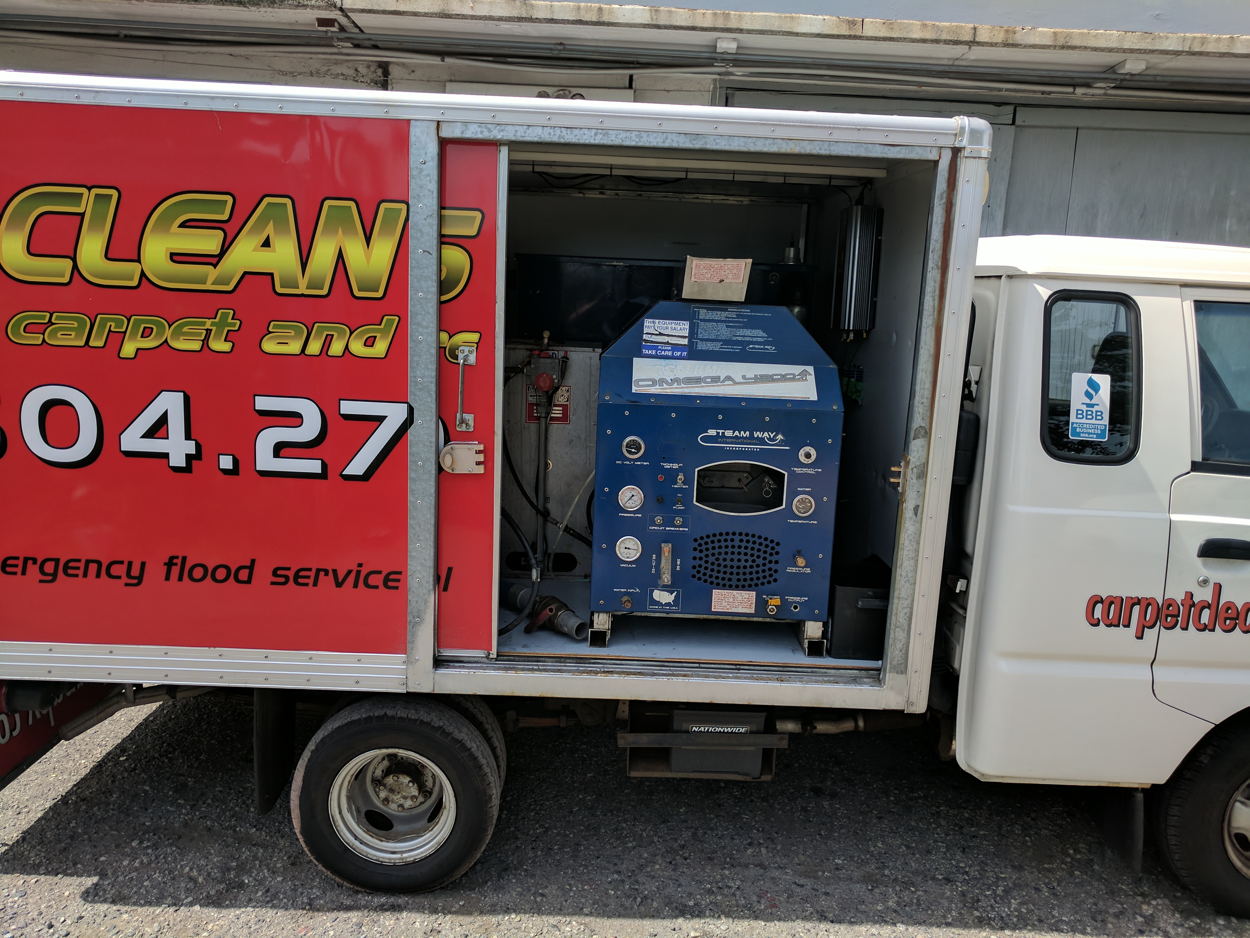

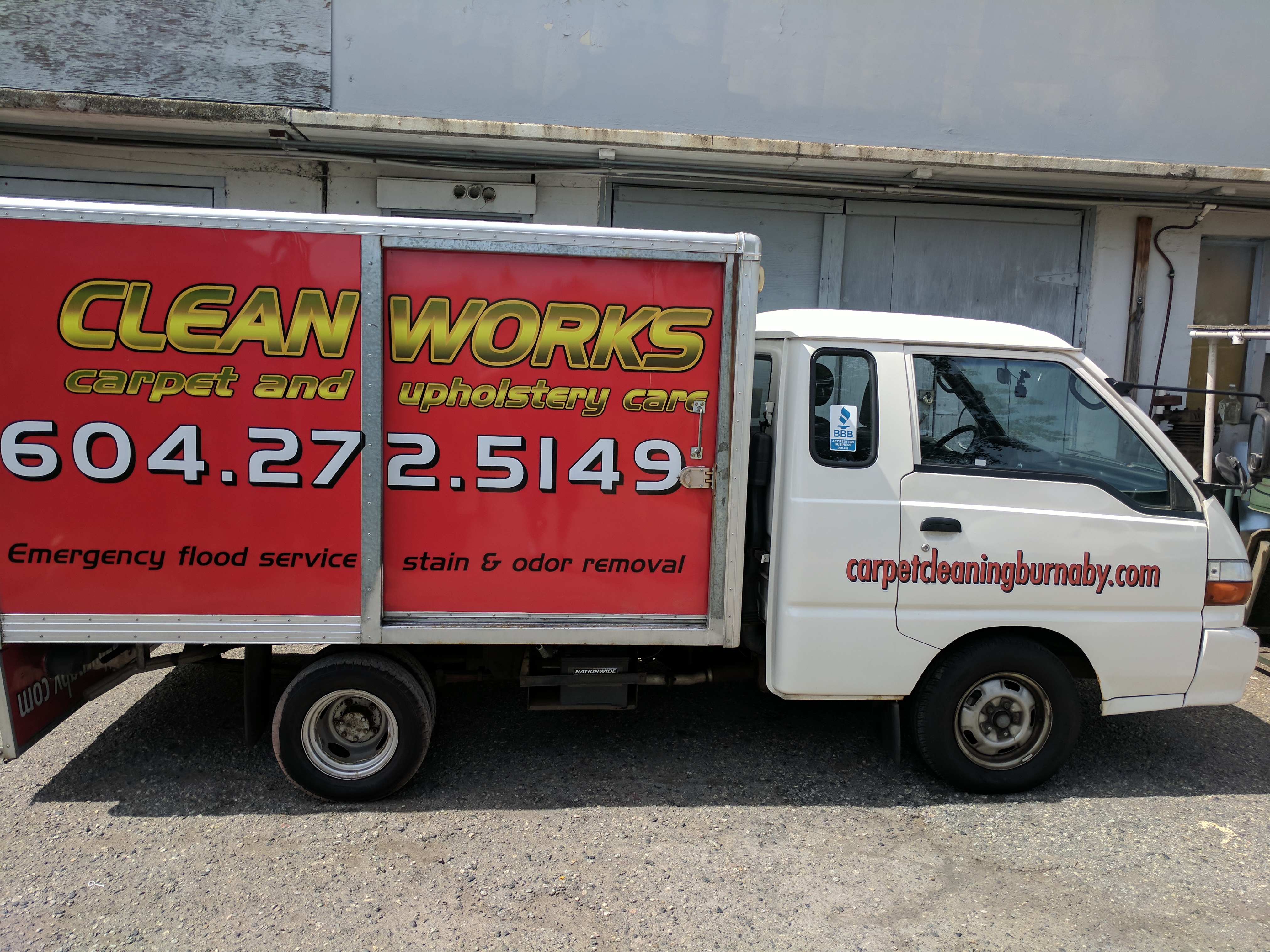

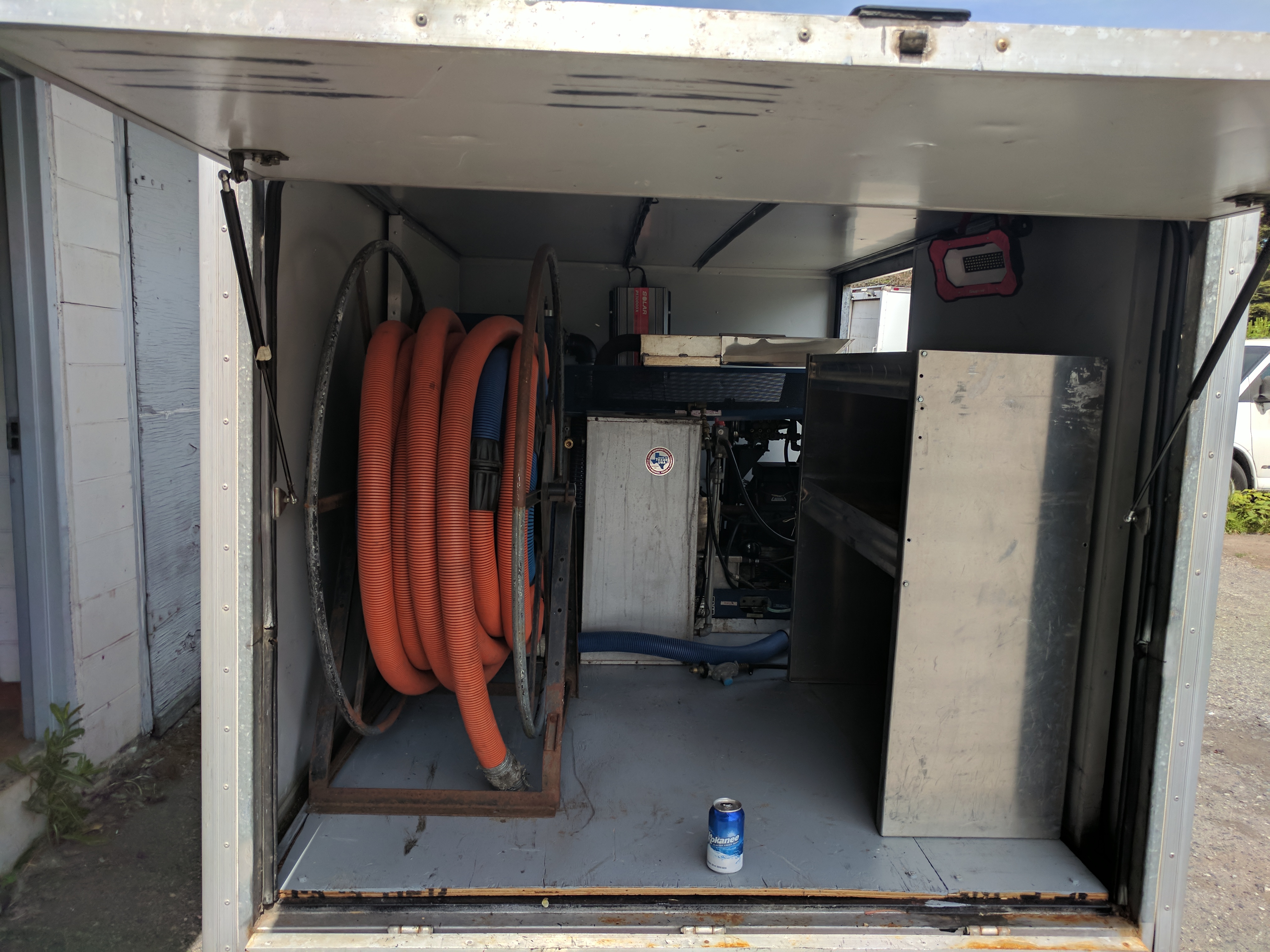

If you're going to buy used, know how to wrench on it yourself. I have always had used, except for my custom built unit in my dodge. I am putting together a little unit in my Hyundai box truck finally. It's an old Steamway unit with an 18 hp Kohler, a cat 3cp pump, a sutorbilt 3lp (36) blower and a lg Ht3 Propane heater. My mechanic has gone through the unit, compression is good, done a tune up and now it's up to me to install it. The blower is rated at 350 cfm at 3600 rpm. I will be running it somewhere around 3000-3200 rpm. Should be good for 200 ft of hose. Even at 300 ft, it will still be better than a portable. The propane heat isn't dependent on the engine or blower and is consistent. If any component fails, it is easily replaceable. I'll post some pics later.
View attachment 91644 View attachment 91645 View attachment 91646
In these pics, nothing's bolted down yet, that's old hose that's extras from the shop, yes, the hose reel needs to be painted, the heater is there for sizing, the actual heater is an lg high pressure 3 by so I can use it for tile cleaning. Not a lot or room left over but I can still fit a vacuum and crb, etc in there.

NUTS. I was very careful to get all the right size bolts, flat washers and lock washers but I forgot the nuts. One more trip to the hardware store and I might get everything bolted down today.
