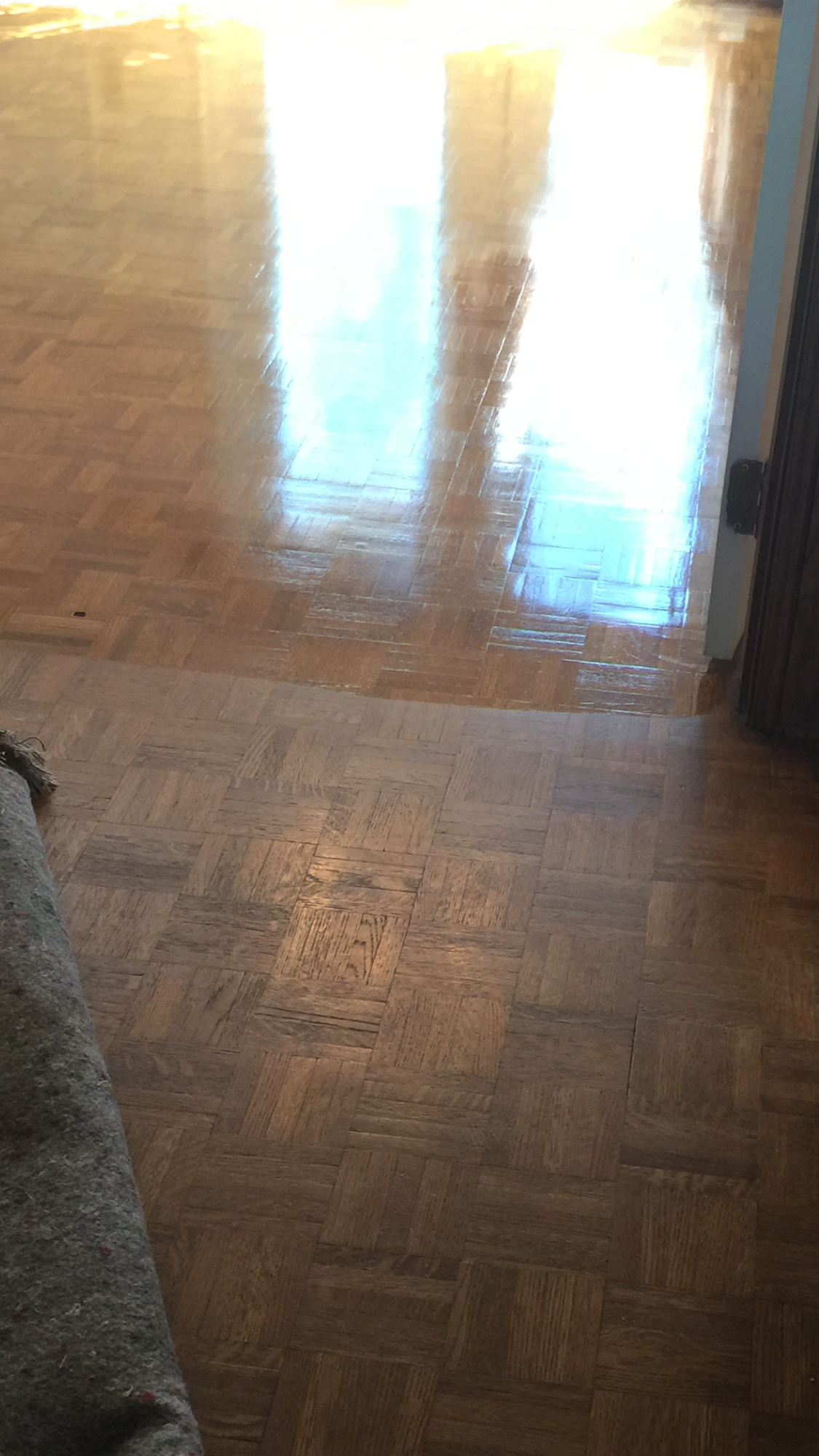

Ive only do once so far..only a vacant living room about 200 sf. I used my 175, red pad and squeaky clean. Then i applied refinisher. I learned this through truaman videos.... I charged a dollor per foot in this case. Turned out real nice. Probably lasted 3 months...

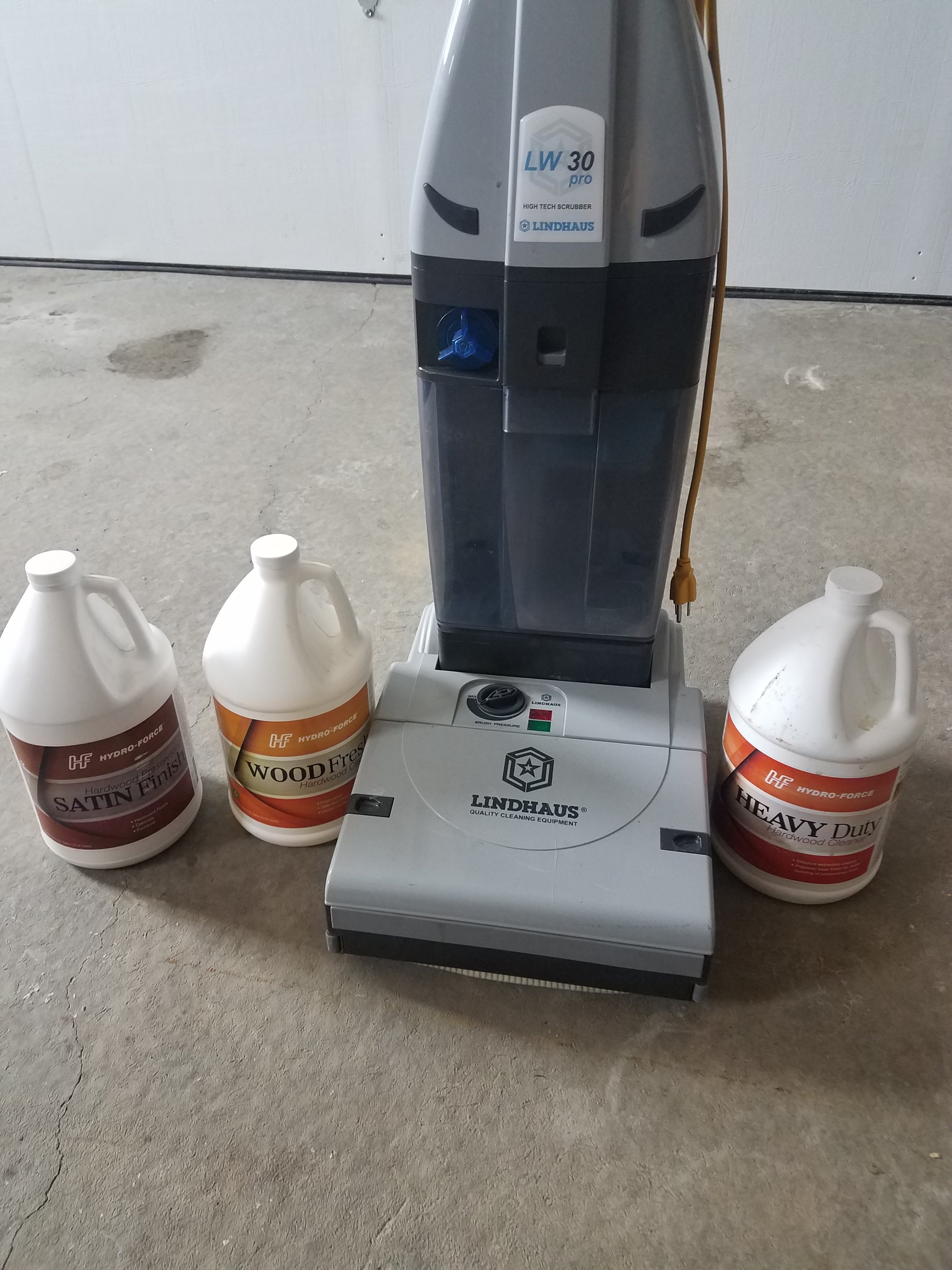

I really like the Lindhaus and Hydro-force line of wood care products. You can do Hardwood or Engineered Hardwood. The Lindhaus eliminates over wetting and is dry almost immediately. This is huge when working with engineered hardwood. @Scott W recommended this setup to me last year and I haven't looked back since I bought it. Great tool for making money!
Reactions: J Scott W
Oct 25, 2016
3,226
Swani
I have the LW30 that I bought used.
Reactions: DAT and J Scott W
