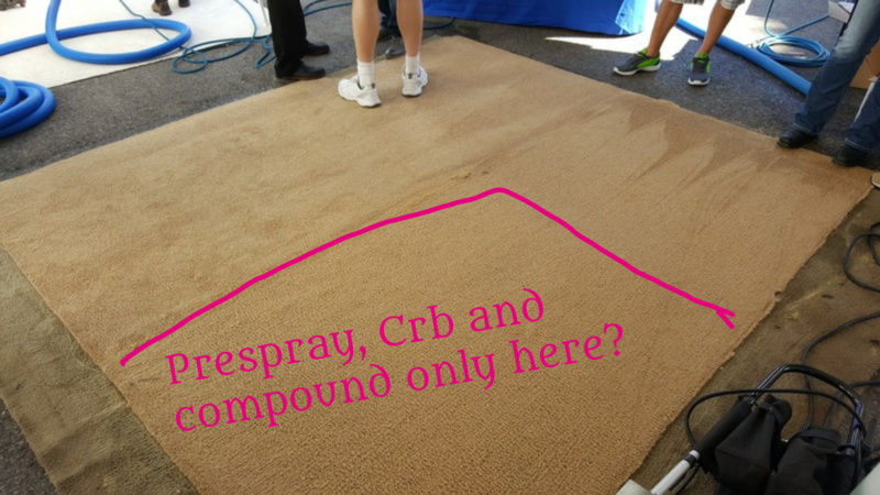

Right/lower side was CRB'd
Fluffier and brighter, which I give credit to the large amount of shampoo that was used.
A LOT of compound was left behind...
So the "fluffier brighter" side was only presprayed and crb-d and compound cleaned? No extraction?
11,538
Your line is correct but it goes all the way across 1/2 the rug, I think he pre sprayed it with a half gallon of encap scrubbed it in and then absorbent compound scrubbed that in then used renovators.

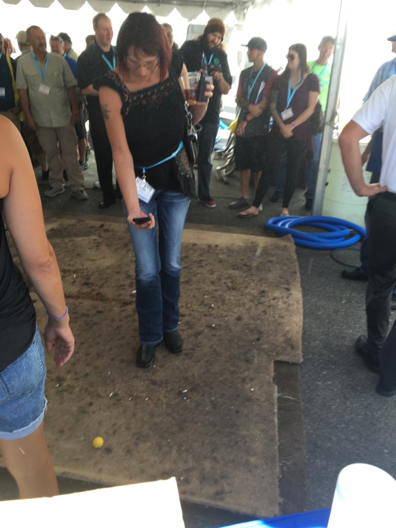

View attachment 17920 The Crb pre pulled a ton of hair, then used encap on half scrubbed in, then added saw dust scrubbed that in, then used renovators to pull up remaining saw dust and hair. That side looked really good.
The Saiger sauce super spinner Aerotech side.
Was pre treated with sauce no additional scrubbing just super spinning and Saiger saucing.
It looked brighter but the side with crb 20 times over had less hair.
I said to Mark before the spinner they should've hit it one more time with a crb and the sauce.
A spinner is awesome but it's not a hair puller.
It definitely needed some more agitation. I would have gone over it with another CRB but seriously didn't want to dirty another CRB....
