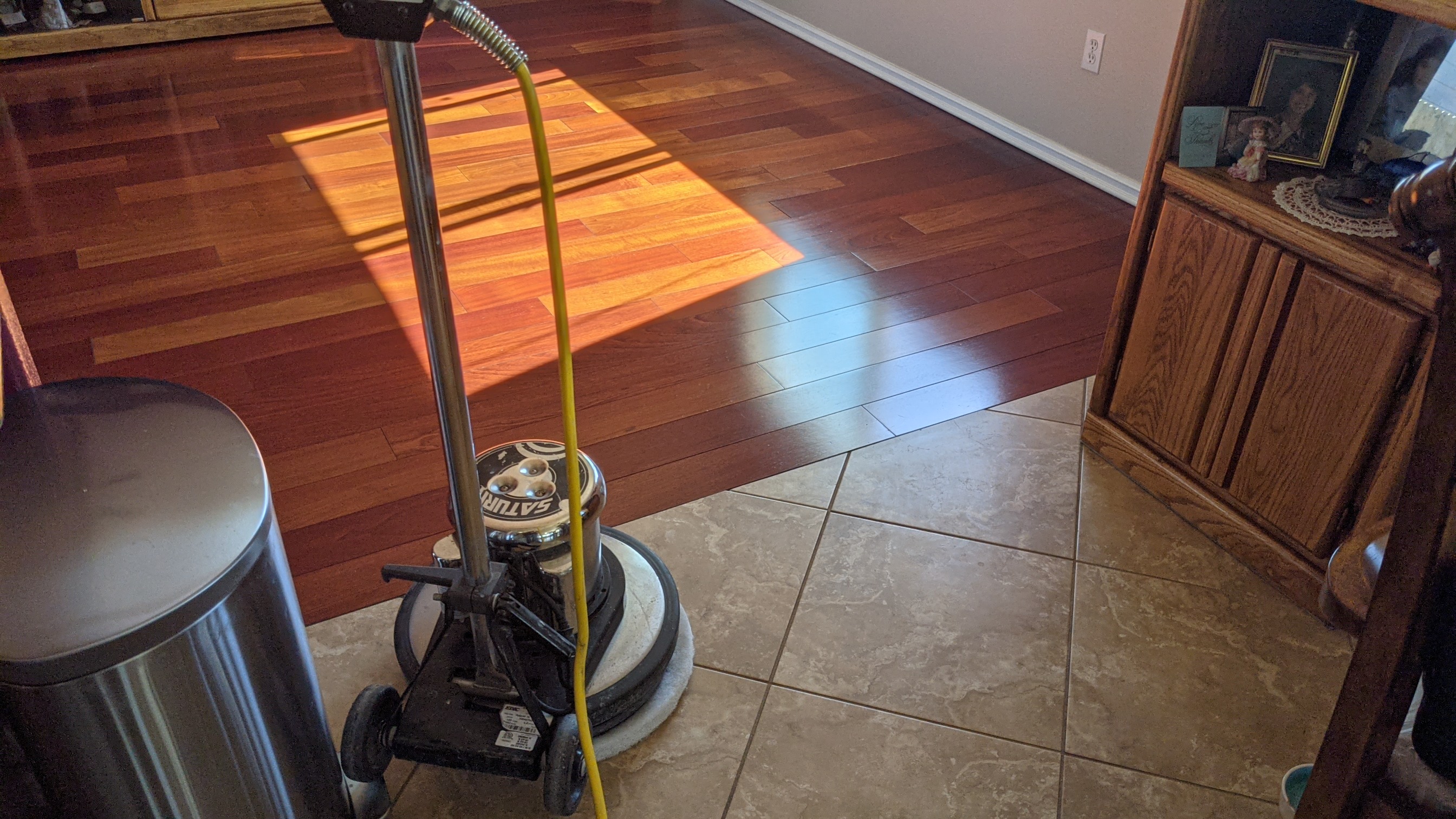

Used a square scrubber with SPP pads. Just vacuumed up the wax. Noisy and dusty mess but no stripper.
That will do it. It will do it on vinyl too. But I tried
to share that wisdom on another board and of course they said that, and I was stoopit. Kinda like hwe or low moisture🤷🏼‍♂️😉 I told em to bite
me, you can’t fix stupid!

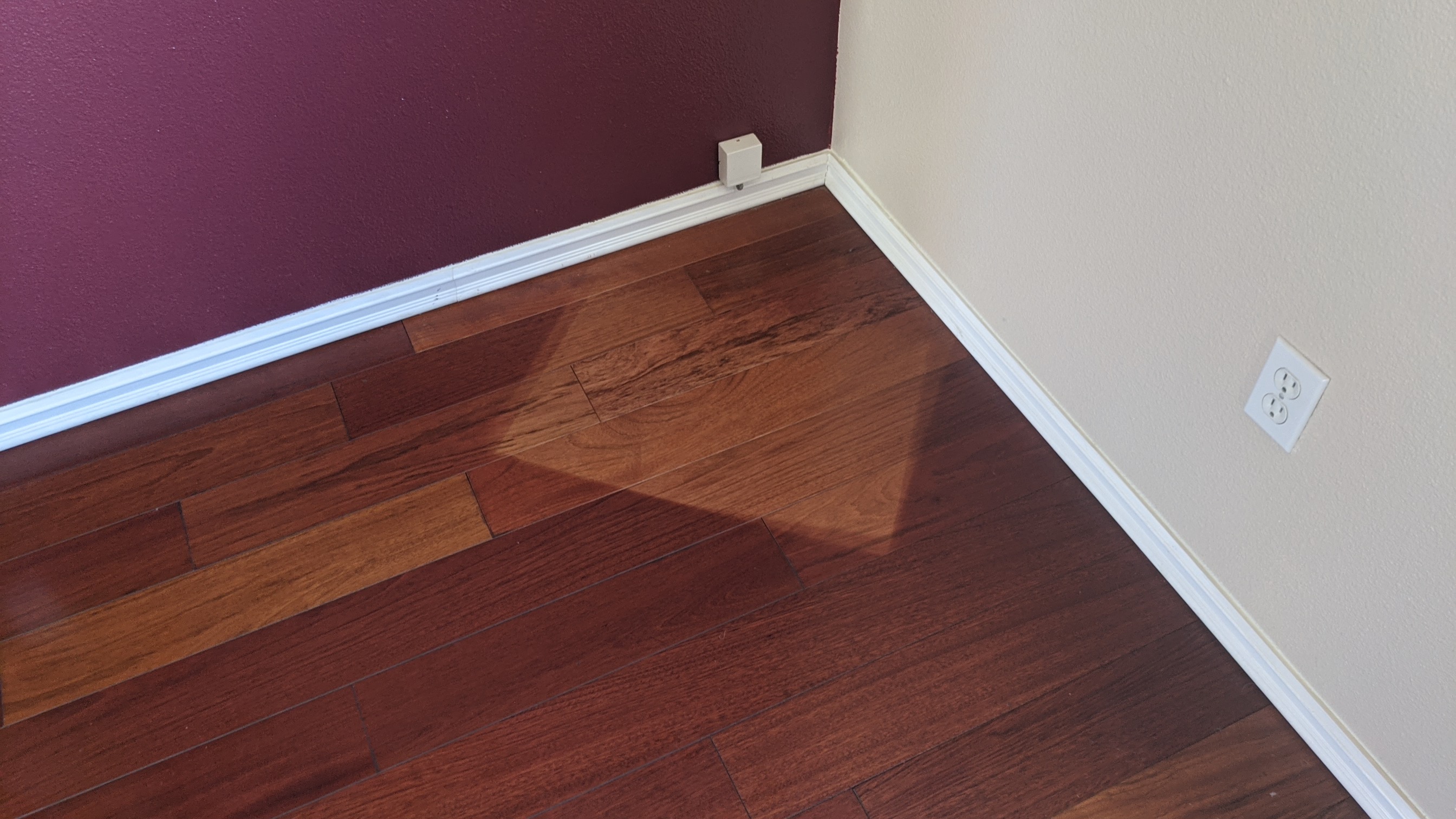

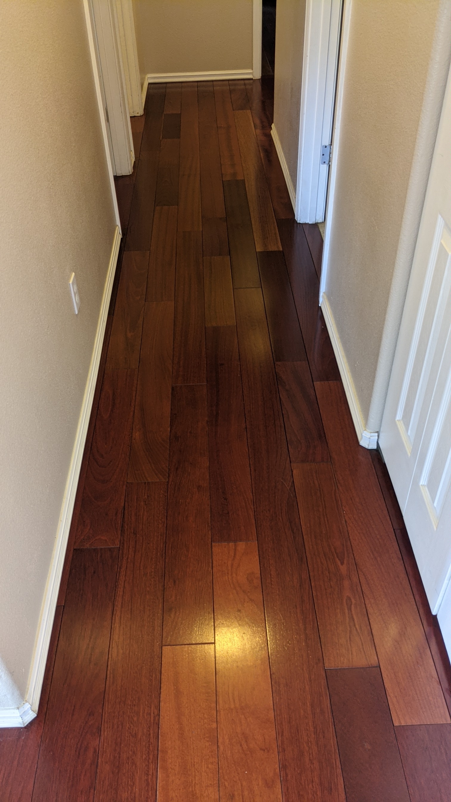

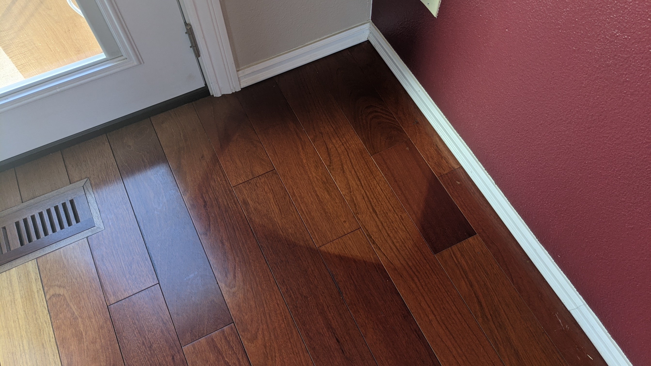

Reverse fade, it happens
Oh, so you didn't try to fix it. You made it look like you had a secret miracle to fix that fade.
That floor didn't look that bad. I'm trying to find areas that showed somewhere where your services were needed. I see some lighter colored lines in between the planks. Was that where the wax was showing? Otherwise, it looks like you didn't do anything
117,202
The Bona finish layer wouldn't show up in pics...
