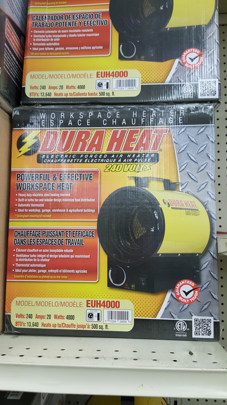

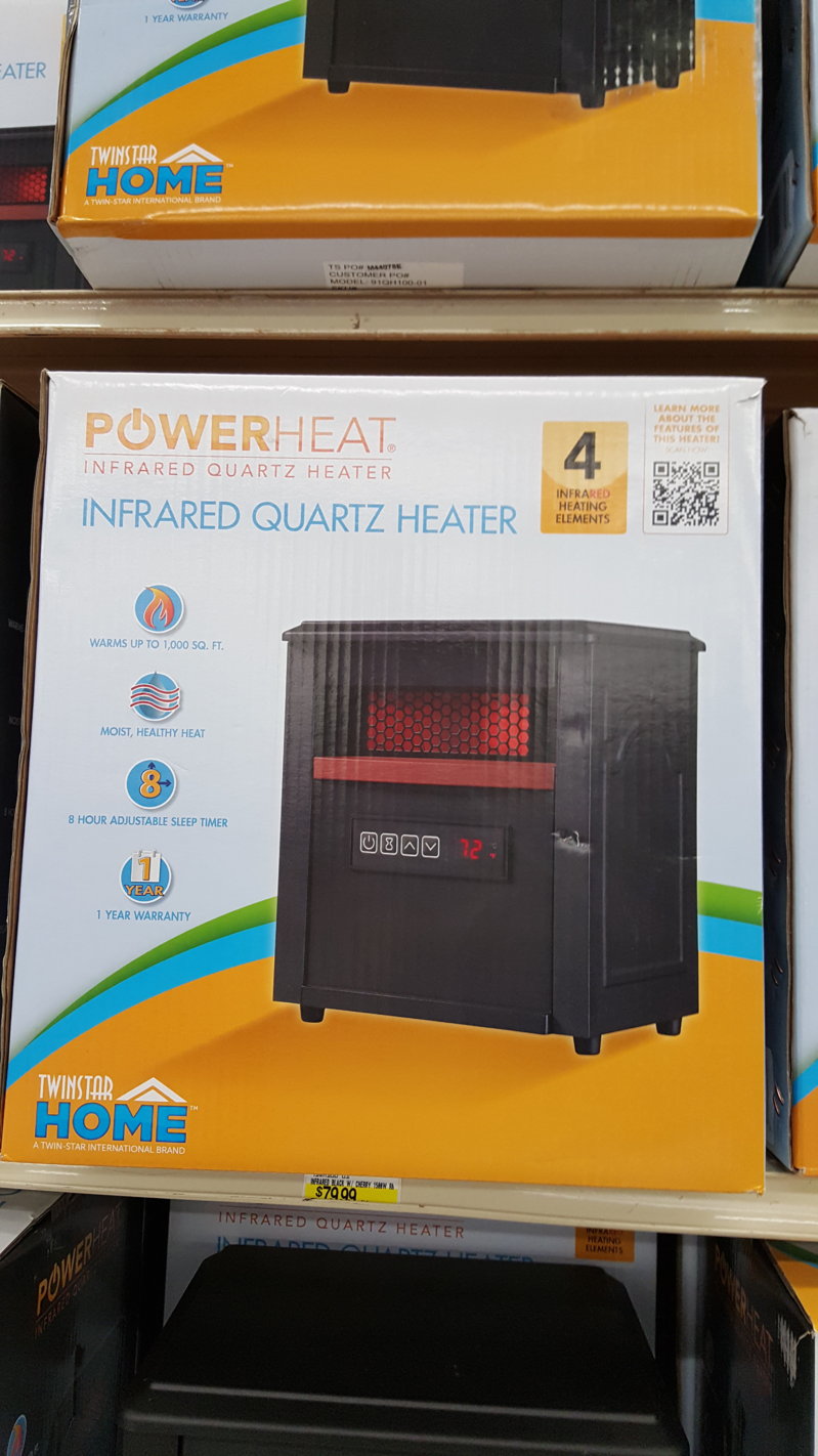

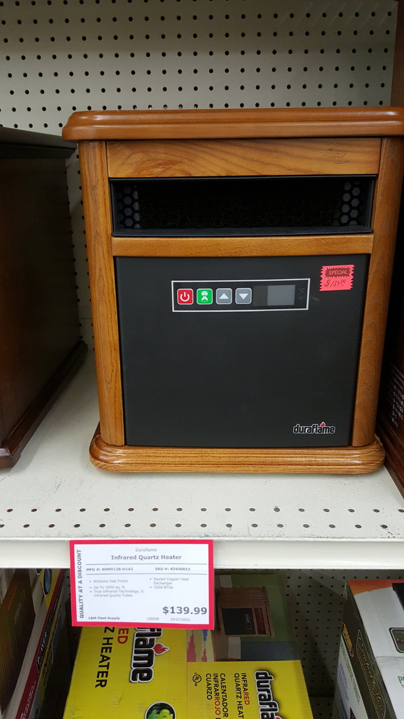

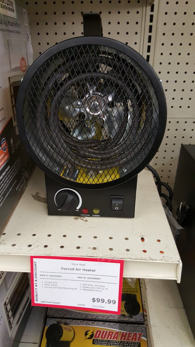

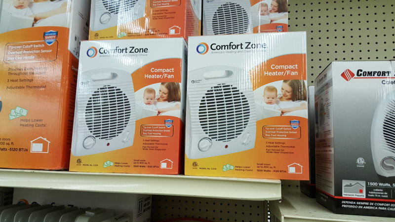

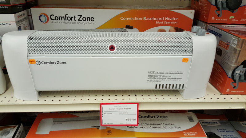

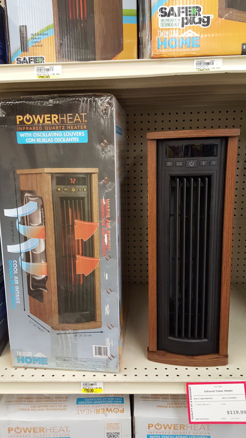

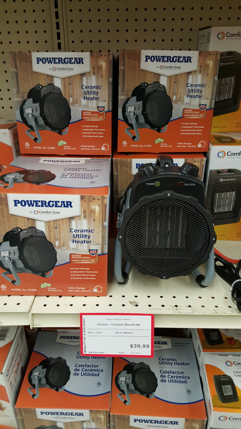

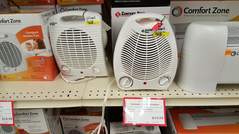

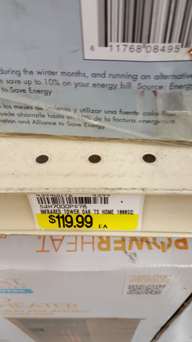

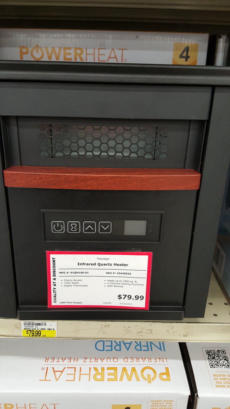

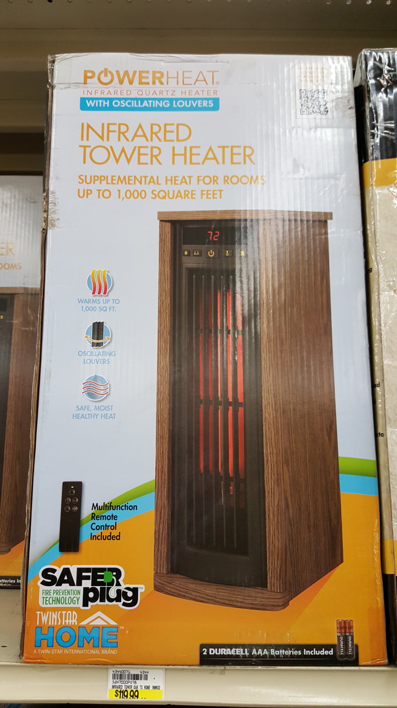

If you do not have a shop...(but if you live in as cold a climate as me you really should!)
I was walking around the local L&M Fleet Farm tonight and thought would take a pic of some heater options...
If you are doing this kind of heater, you really do need slight air movement to circulate the heat...
You will also want at least 2 heaters....and EACH ONE ON A SEPERATE CIRCUIT WITH NOTHING ELSE ON THAT CIRCUIT!
So if you run 2 heaters and a small fan...you will need 3 circuits....
Each one of these heaters can put enough stress on a circuit to blow the circuit....
Some of these also WILL NOT RESTART THEMSELVES IF THE CIRCUIT BLOWS.
Some of these units have a fan...some do not...
Also, some are still a fire hazard if you get something flammable around them (or fuel fumes)
So just some pics and ideas for those of you saving up for a heated shop :)
I DID NOT TAKE ANY PICS OF OIL FILLED...THEY ARE OK...But I don't feel they really put out enough heat fast enough....

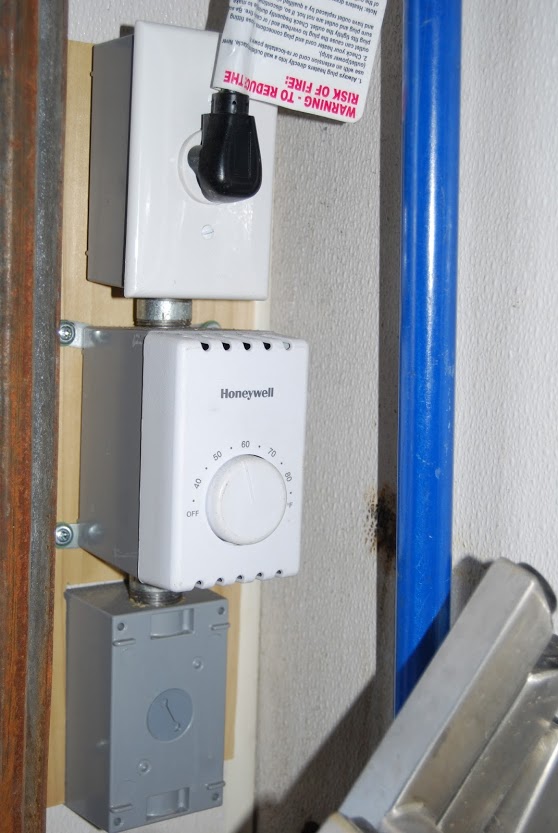

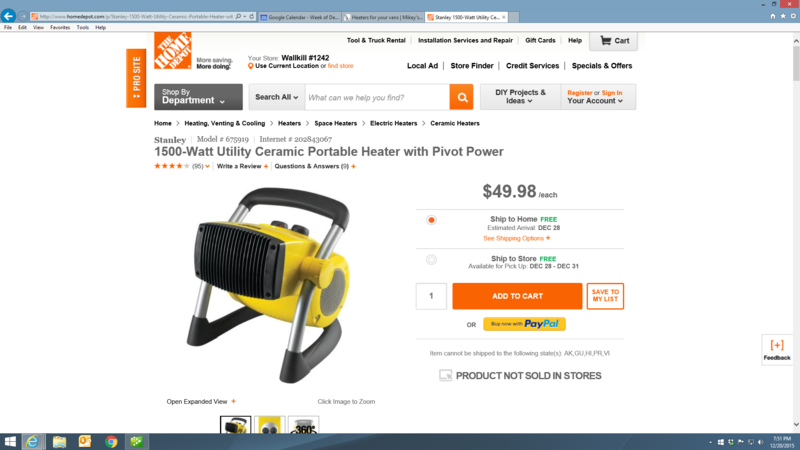

Yes that's the one.. I also have a industrial in line thermostat that I set to 50 degrees and put it next to the heat exchangers.

Most of the heaters with digital controls won't come back on after a power outage (even a brief one) and should be avoided. Heaters with basic manual controls, such as the so-called "milkhouse" heaters will.
http://www.walmart.com/ip/17808701
In any case, test any heater you buy by pulling the plug, and make sure it comes back on when you plug it in!

The Stanley will come back on.. I also have the heater you posted Dan. I like the size and shape of the Stanley.. Or maybe it was the color.. :lol:

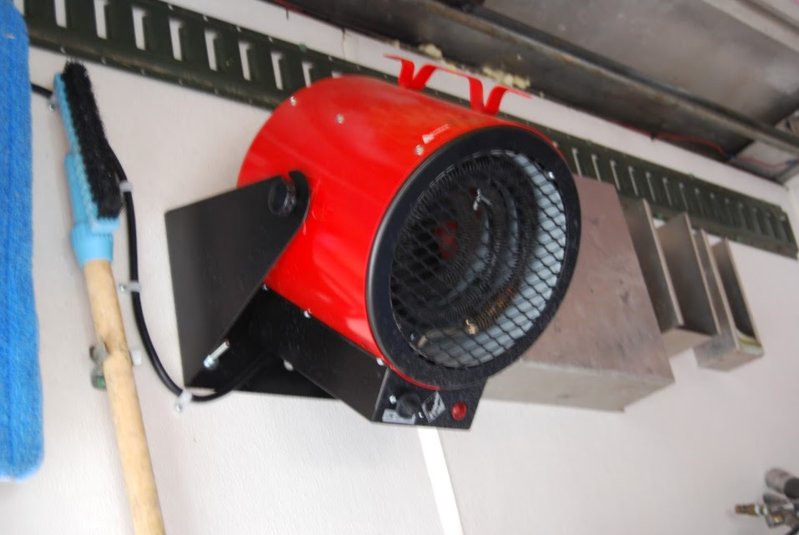

Yes it is 220 and a 4,000 watt Heater It has a big fan to get the heat through the boxtruck. When I get to my job , I turn on this heater to keep my truck warm while I am inside talking to my customer. After my truckmount runs for a while I can turn it off
