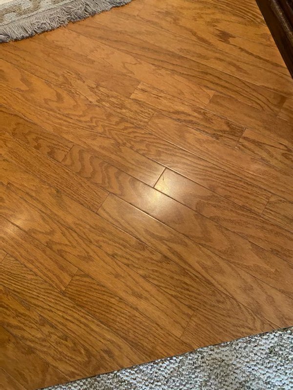

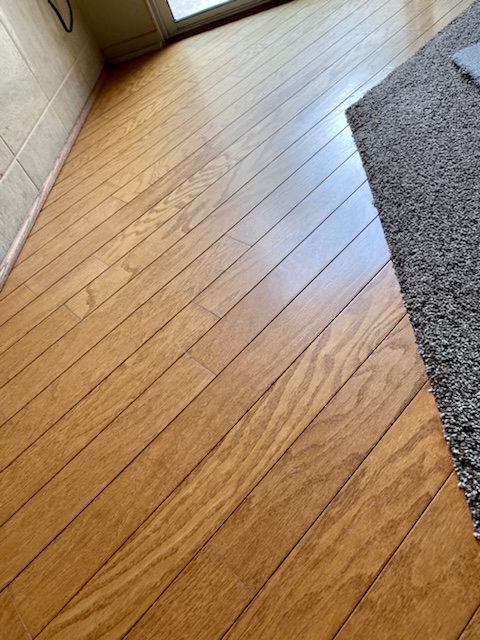

So we were using saigers code red (yes I’m blaming mark) on a residential job and my technician walked from the wet carpet to the wood floor and didn’t wipe it up
now at exactly 8:47 am there is a shoe print on there floors that will not clean off
I put some pictures here but can’t see the mark
what would you guys do to fix for the customer
47406F92-3939-4B88-91E8-2E9940F3C709.jpeg 279FB9E6-9B0F-4534-B5E1-2455DC710477.jpeg
All preconditions will do that if left to dry. Not just Mark's products.
Its needs to be wax where stripped and should be fine. Wood creme restorer would also do a great job of removing the dead wax footprint and adding back the shine if you have any of that around.

Thanks for the help I was definitely joking about blaming mark
also would I just add the wood creme restorer

Since that floor has the #%%* stupid grooves between panels, it's prefinished flooring that has a tough polymer finish that's actually pretty hard to hurt. You could try using a mild solvent like OMS or turpentine and rubbing the area with 00 steel wool to remove residue or extremely light etching. If print remains, the right gloss level of polymer finishing product would be the fix.
And if you haven't made friends with a hardwood repair guy yet, maybe now's the time.
