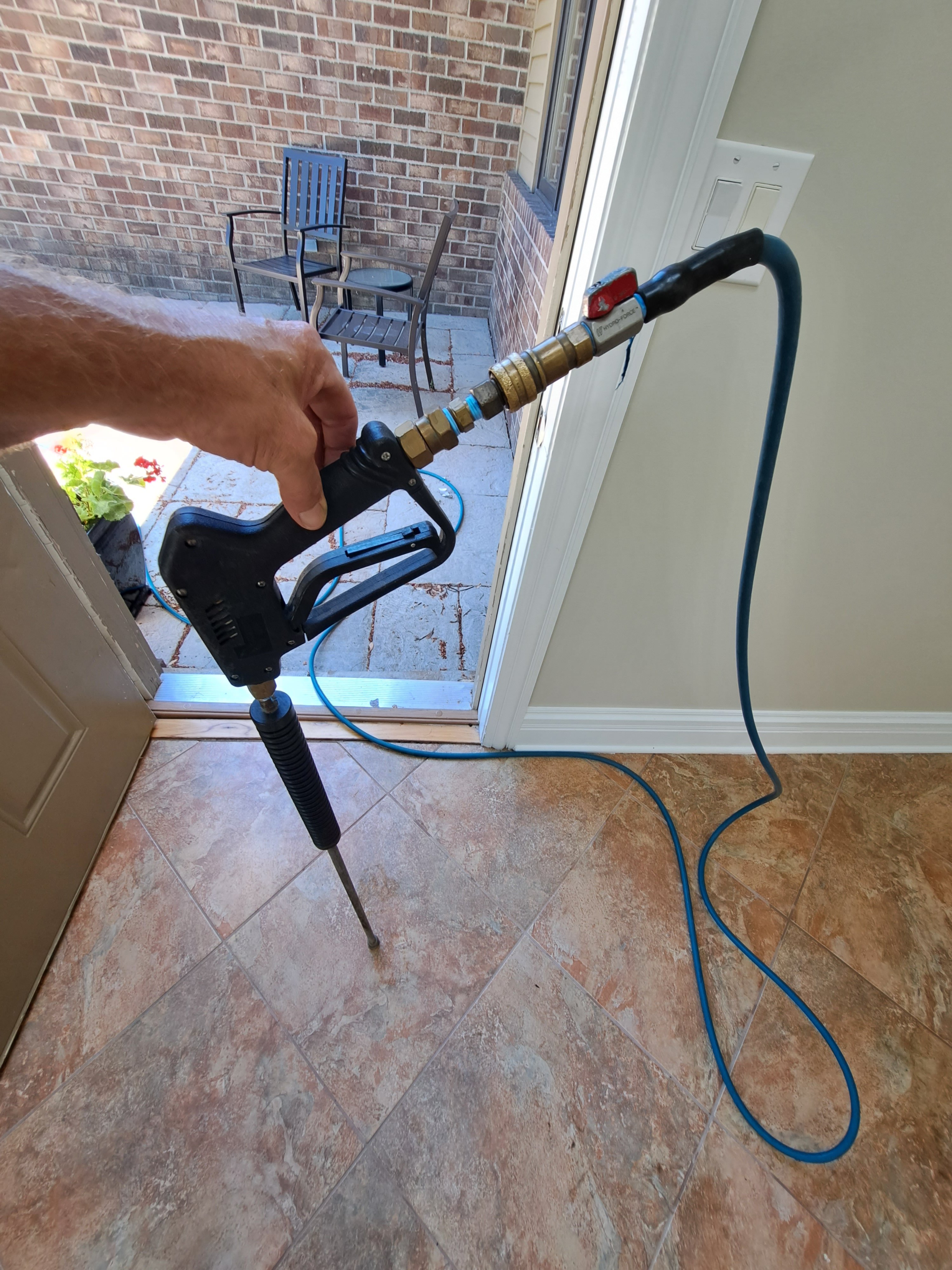

I keep a pressure washing wand on the van.
I clean porches and sidewalks quite a bit.
I use it to clean other tools also like the brush on the floor tool.
